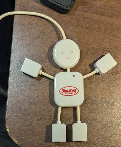

Something in the Win11 update made long standing USB 2 devices on USB 3 connection problems come back. So I swapped out the USB 3 hub with an old USB 2 hub I had lying around.
That fixed the problems!
There must have been some change in Win11’s update that brought back USB2 v 3 issues and using a USB2 hub avoids the problem.
