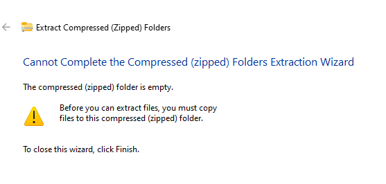

Thank you, Nathan. In the ZUSBESC0200ZACG user manual (under the DigiKey datasheet link), there is a link to download the software for the product. The “readme” file on the Zilog site admits to a “Microsoft SmartScreen” error, but states to ignore it and proceed with installation. However, windows cannot open or extract the downloaded zip file. Does DigiKey have any experience with downloading and installing this software? Is there another way to obtain the software?

Thank you, Kristof, but I am not getting that prompt. When I try to extract the zipped folder, the error message is:
The file is not empty, however; the size shows 22,491 kb.
If I try to open the file, the message is:
Windows cannot open the folder.
The compressed (zipped) Folder…is invalid.
I downloaded the zip file to my laptop and got the same error.
Looks like Windows compression utility doesn’t like the format.
I downloaded a third party compression tool, WinRar, and was able to extract and install the executable after I went through the warning More Info Run Anyway steps.
I just want to quick summarize the error so people with search engines can find this:
Downloading Zilog’s zip archive for ZDS II - Z8 Encore gives Microsoft Windows an error message when attempting to extract, the message indicates “The compressed (zipped) folder is empty.”
Thank you, Kristof, I had the same success with 7-zip.

Hello john12, welcome to the TechForum! I also checked out Zilog’s page and the ZIP file appears to be empty. This doesn’t seem normal, so I am reaching out to our contacts to see if there is a problem with the files.

Zilog’s site has run into some compatibility problems causing files to have the issue described. I recently have been given access to the files and they are available for public use so I can share the working zip file.
ZSP_2.4.0_22101201.zip (11.0 MB)
I tested extracting this on my end and it appears to work.
