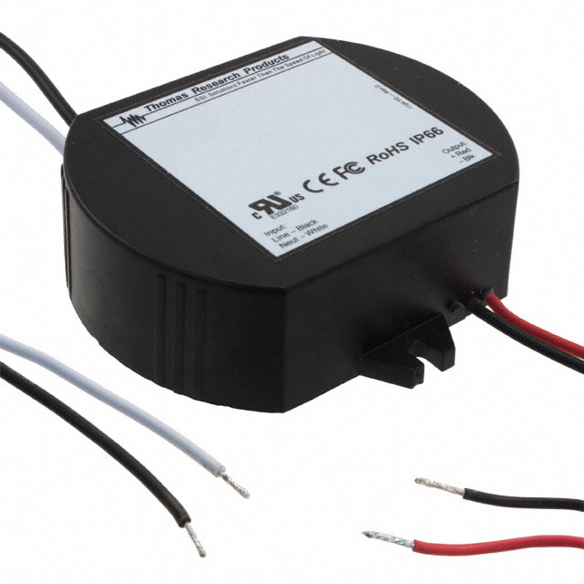

LED25W-24-C1040-LE from Thomas Research Products is being offered as a replacement for Obsolete part RACT20-1050-US from Recom Power
| MFR PART # | LED25W-24-C1040-LE |
| DIGIKEY PART # | 1121-1223-ND |
| MANUFACTURER | Thomas Research Products |
| DESCRIPTION | 1.04A 12 ~ 24V Constant Current LED Driver AC DC Converter Topology 1 Output |
| DATASHEET | Click Here |
| Atributes | RACT20-1050-US | LED25W-24-C1040-LE |
| Product Status | Obsolete | Active |
| DigiKey Programmable | Not Verified | Not Verified |
| Type | Constant Current | Constant Current |
| Topology | AC DC Converter | AC DC Converter |
| Number of Outputs | 1 | 1 |
| Voltage - Input (Min) | 90VAC | 100VAC |
| Voltage - Input (Max) | 135VAC | 277VAC |
| Voltage - Output | 12 ~ 18V | 12 ~ 24V |
| Current - Output (Max) | 1.05A | 1.04A |
| Power (Watts) | 20 W | 25 W |
| Voltage - Isolation | 3.75 kV | - |
| Dimming | Triac | Triac |
| Features | OTP, SCP | OCP, OVP, SCP |
| Ratings | IP20 | IP66, NEMA 4 |
| Operating Temperature | -30°C ~ 50°C | - |
| Efficiency | 81% | 83% |
| Termination Style | 5.5mm Socket, Screw Terminal | Wire Leads |
| Size / Dimension | 5.41 L x 1.98 W x 0.91 H (137.5mm x 50.2mm x 23.0mm) | 3.15 L x 3.07 W x 0.99 H (80.0mm x 78.0mm x 25.2mm) |
To verify this part will work in your application or to view full specifications see the manufacturer datasheet Data Sheet
