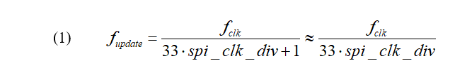

Equation 1 defines the frequency at which the output data updates. This is influenced by the system clock frequency the user provides at the clk input port and the value assigned to the spi_clk_div GENERIC. (See the section Configuring the Clock for details to properly assign spi_clk_div).
The ASL Pmod Controller is set up to provide the fastest update rate available for a given system clock, while keeping the SPI clock rate within its 4 MHz specified upper limit. The fastest rate is ~242 kHz, achieved when the provided system clock is an integer multiple of 8.
