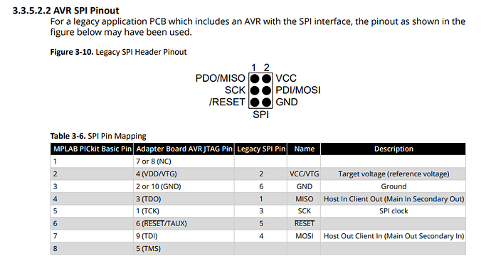

I’m not up on their new stuff, it appears the MPLAB PICKIT Basic can also do AVR ISP programming, PG164110
