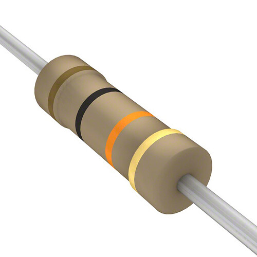

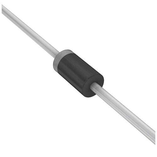

I’d use these in-stock parts based on being appropriate for a simple, last century design, +/-24V power supply and most visually similar:
Resistors :
Diodes:
