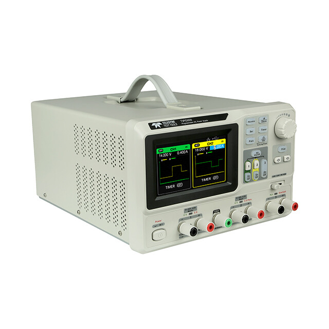

LAB DC power supply
The DC supply used in your school’s lab is likely a dual mode device with both constant voltage and constant current operating capabilities. In constant current mode the supply can:
  • Supply current in one direction
  • Supply its set current up until the required voltage attempts to reverse polarity or until it attempts to exceed the internal voltage rail of the power supply.
In both cases our “voltage will do whatever is necessary” stipulation is broken. A representative Teledyne LeCroy T3PS3000 power supply is shown in Figure 1.
Figure 1: The T2PS3000 may operate in constant current or constant voltage modes.
