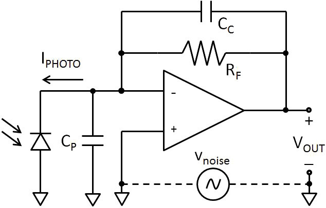

There is a scheme of transimpedance amplifier, and they write that it is noisy.

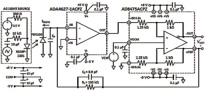

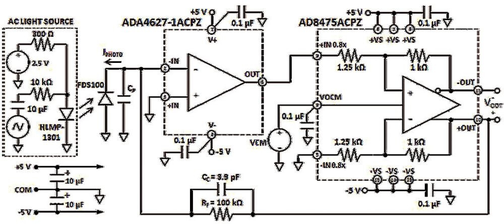

And there is a more complicated scheme, and they say that it is much less noisy
Second circuit
And in the second circuit can I replace ADA4627 chips with OPA827 and AD8475 with OPA1632? Maybe you have met a circuit similar to the second circuit somewhere in the datasheet, I have more confidence in the datasheets, if I see it, there is a better chance that the circuit will work.
These circuits were taken from the articles.
If you have any ideas or know of any quieter circuits for photodiode amplifiers, please let me know.
