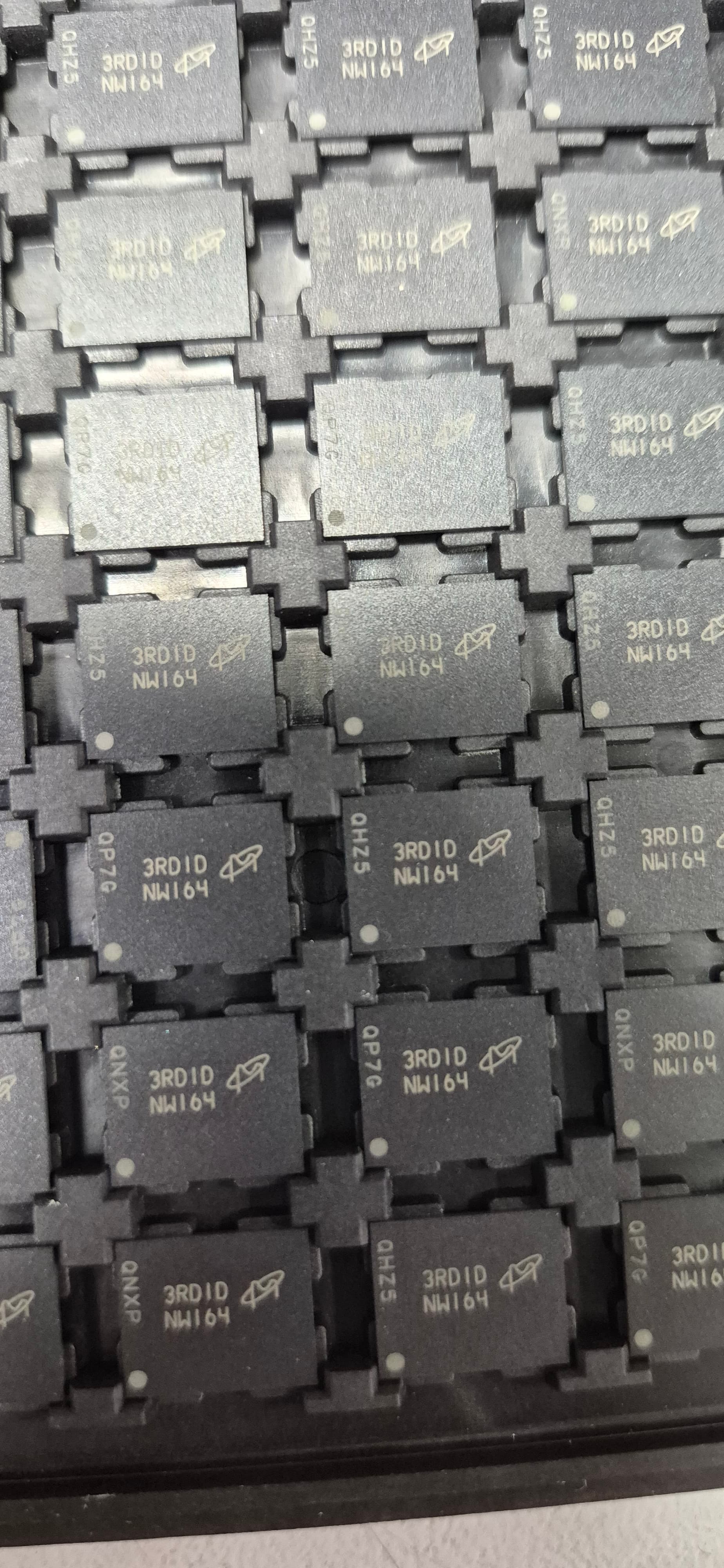

Can anyone identify what part or even manufacturer this may be?
It has a "M like " logo on it and marked 3RDID (top row) NWI164 (2nd row) then on teh side it has either QHZ5 or QP7G. Any help is appreciated. Thank you!

Those are Micron parts (m logo)..
NW164 should be the package (VFBGA63)
Pretty sure it’s mt29f family of nand flash.
Micron’s decoder FBGA & part decoder | Micron Technology Inc.
Decoder= SLC NAND part detail | Micron Technology Inc.
