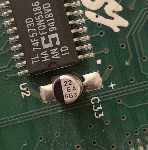

This Macintosh accelerator card (a MicroMac Carrera040 for those who might be curious) has 3 of these caps. I think I understand these to be 22µF based on the 22, but not sure about the 6A or the 5G3.
Any help would be greatly appreciated!

Hi, Please take a look at the link below. These are 22uf 6.3v alum smd caps. The 5G3 could be a date or lot code. You will need to measure the diameter of the cap and line up the solder pads measurements to know which one might work for you.
Click Here for similar options.
