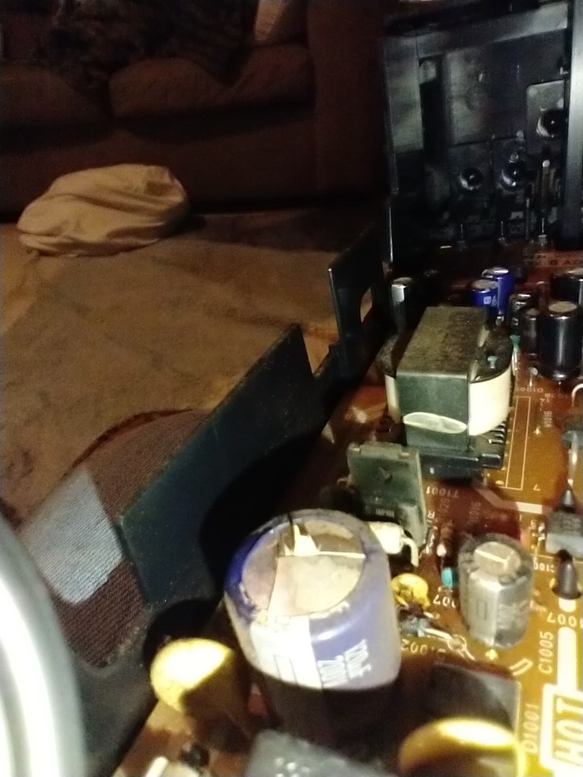

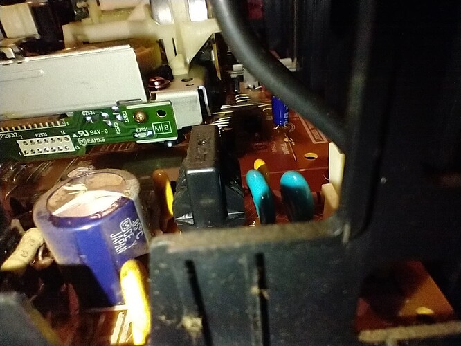

Sorry these pictures are of questionable quality, but what kind of replacement capacitor do I need in my RCA VCR? The capacitor is around a dime wide and a nickel high. Forgive my money measurements…
Thanks,
Miah
Thanks,
Miah
Thank you for your inquiry and welcome to the community!
It’s kindof hard to make out your capacitance value and voltage.
Is that 120uF at 200V?
If so here is a capacitor that is about a dime in diameter and a nickel tall.
200BXG120MEFC16X20
