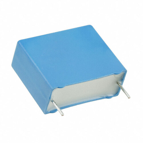

I am fixing a coffee grinder made in the 70’s in Europe.
I cannot find the same capacitor, can you please help me to find one that I can use instead of the old one.
I try to look for one with those specs:
0.1 Uf
400Vac
1500Vdc
85 Degrees
Is that the right way to look?
Thank you in advance.
The picture should give you a better idea of what it is. IMG_1945|375x500
The picture won’t show for me but judging by your description and specs I think this is a through hole, AC line voltage application in a 1970’s consumer appliance. Assuming that is correct I would also recommend you get a replacement with an X rating for line voltage safety.
DigiKey has two suitable substitutes:
This one may work if the original is PCB mounted and has a similar lead spacing.
This one should work for any terminal strip, wire lead, or PCB, mounting style.
