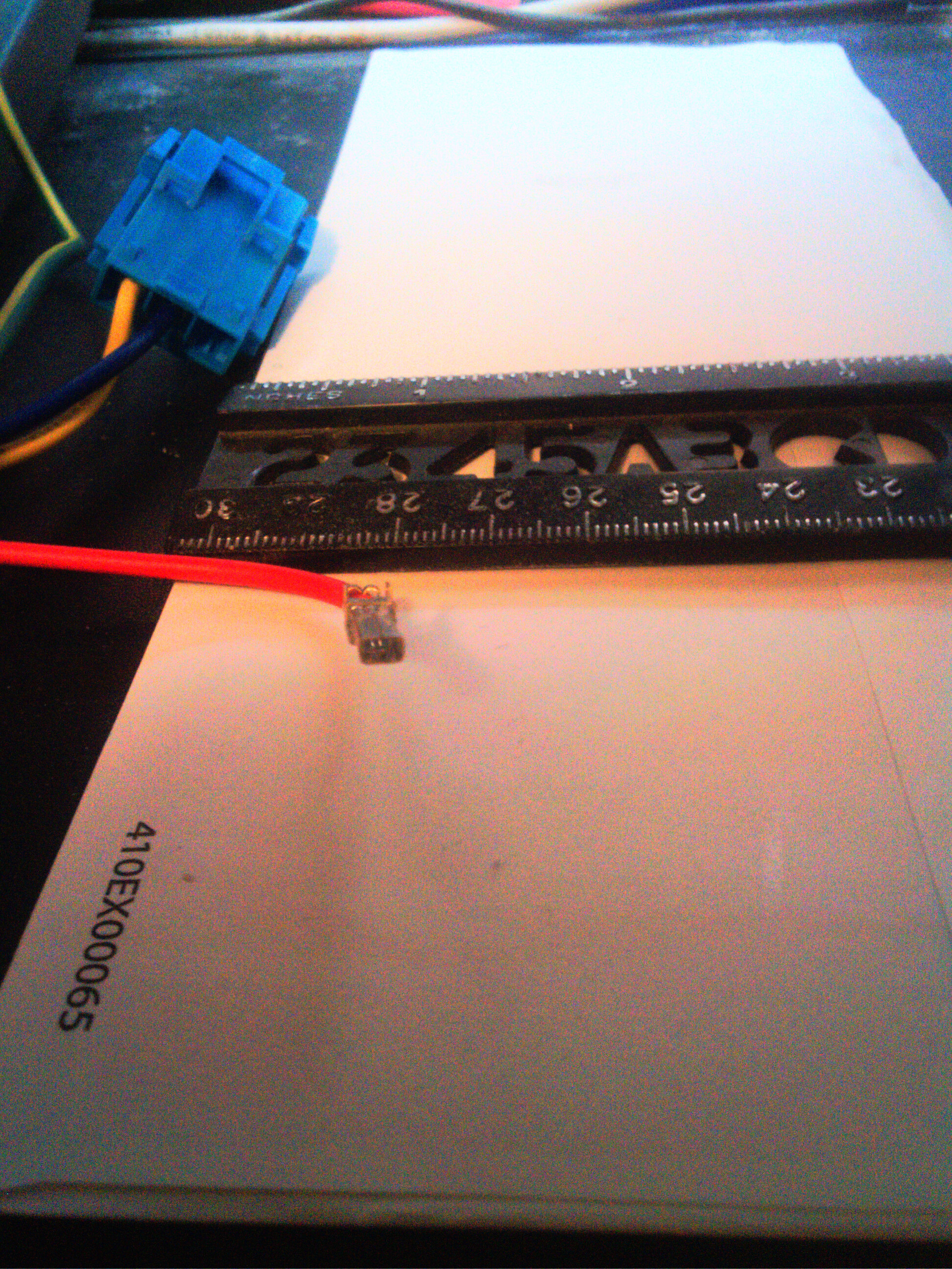

I’m having troubles finding a mating connector to the wiring harness part number in the title. I have several pictures stored on Google drive and can provide any measurements necessary with a digital calipers if requested.
I did find a decent picture of the mating connector in a Youtube video and took a screen capture of that item:

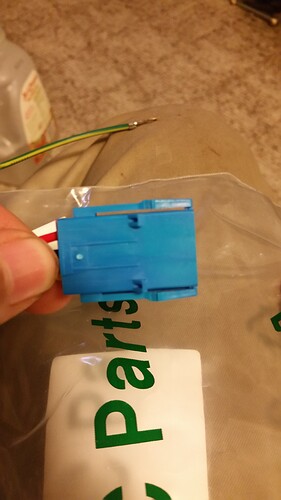

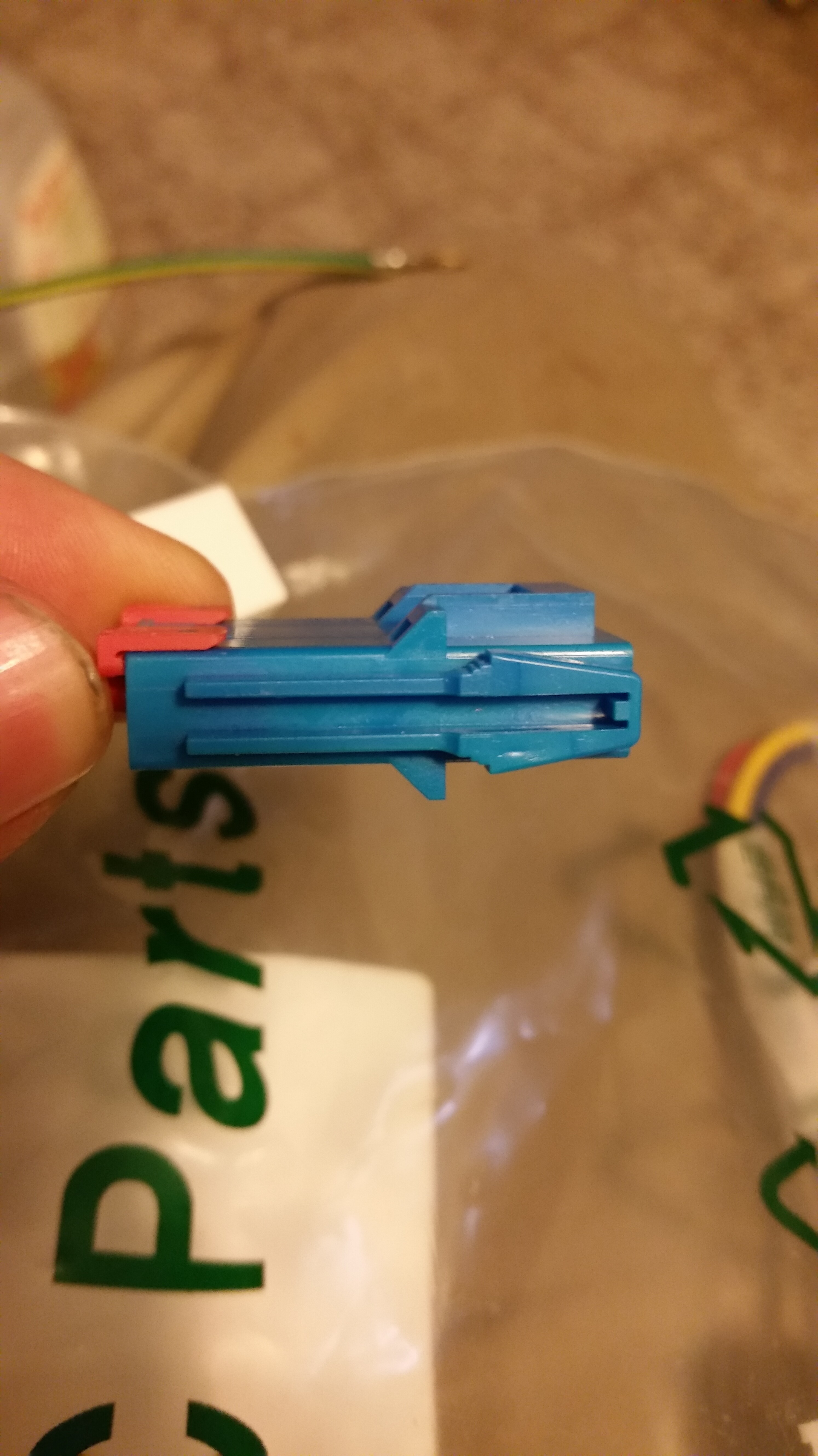

Here are the pictures of the housing that I have:
(more info to come)

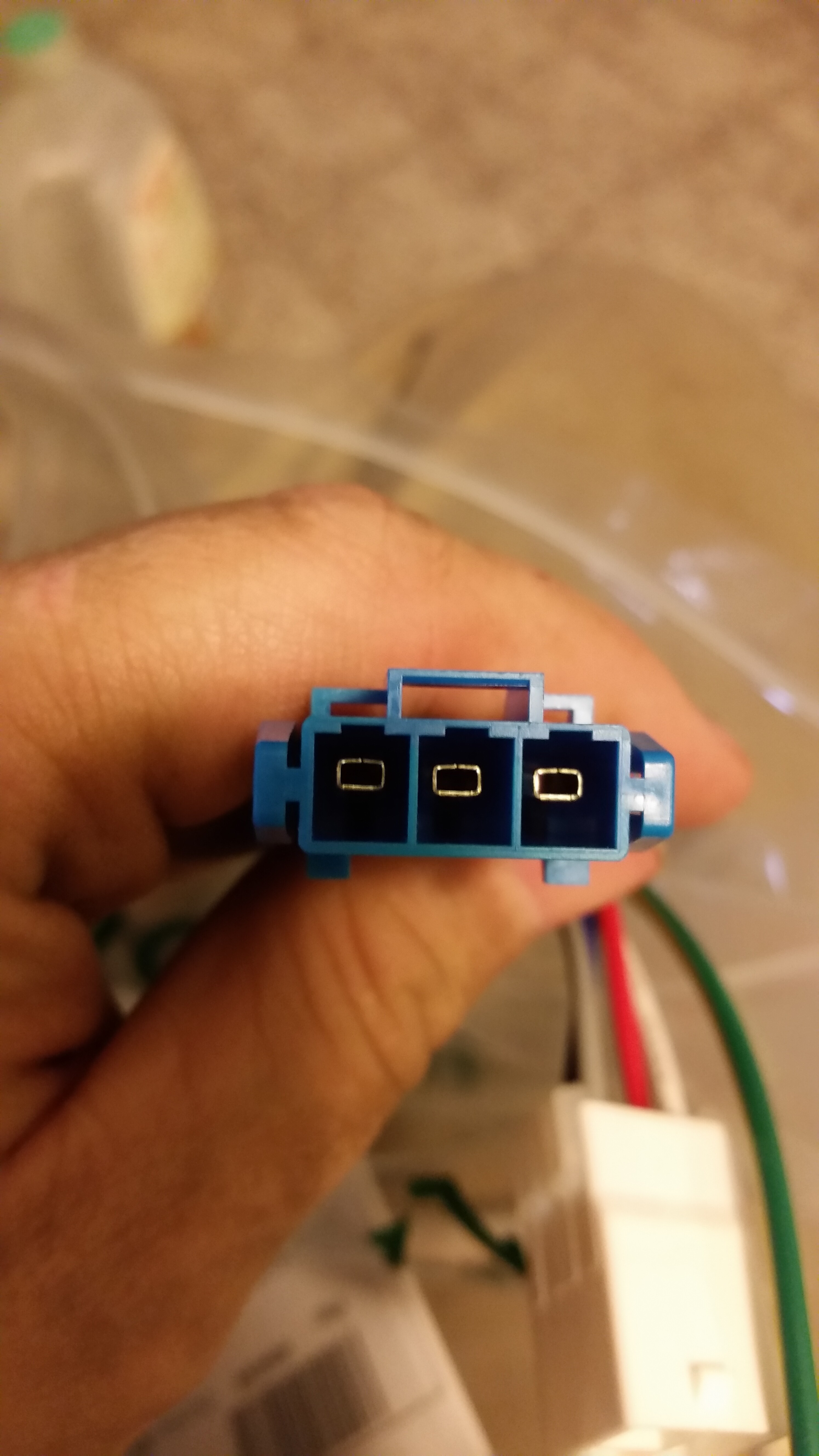

And here are pictures of the terminal pins inside of the connector:
I was able to use an extractor tool to get 1 loose from the housing. I used my calipers on the outer edges of the tip of this terminal and get dimensions of 3.17mm x 2mm.
I know that this wiring harness is used in LG front load washing machines but as long as I can find this connector, it will also work for my application too. If you want more pictures or dimensions, please let me know.
I don’t care if the mating connector is blue or not. If I have to, even just getting the matching terminal pins will be enough as I am not afraid to 3D Print the correct connector.

Take a look at VLR-03V JST Sales America Inc. | Connectors, Interconnects | DigiKey
I think the one you have there is a variant of this, perhaps made for LG as David suggested.
I can see some polarisation features that differ, so might not be perfect, but it looks like at least the right series and I hope will lead you to the correct terminals.

Could the mating connector be this part from KET?
http://www.ket.com/en/product/detail-information.ket?partNumber=MG615664-003

Looks like you are correct. I’ve ordered the part. Too bad DigiKey doesn’t stock this.
Sorry, I should have realized that JST was the creator of this unmarked connector. Next to Molex, I consider them to be #2 in the connectors market.
