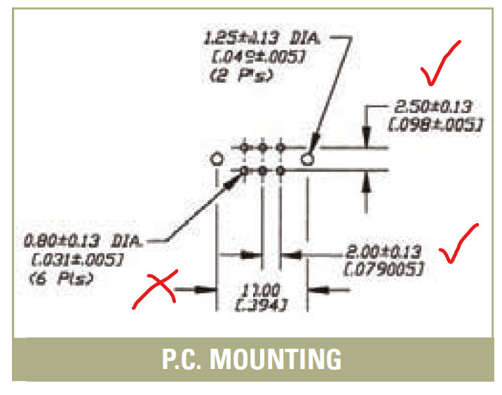

Hi, I am looking for a drop in replacement switch for part# SWSK22D14G7
SWSK22D14G7 APlus Dwg 11-12-19.pdf (540.8 KB)
any help appreciated!
EG4367-ND was found. It’s foot print also matches nicely.
EG2219 E-Switch | Switches | DigiKey
Thanks, I did see that one but the lead spacing is double what my current switch has. I was hoping for a “drop in” sub.
@jbailey
I am not seeing that the spacing would be double.
Drawing for that switch.
My switch drawing shows 2mm spacing between the leads and the EG2219 shows 4mm spacing between leads.
I see. I will double check other options.
@jbailey
I am sorry to say that so far I am not seeing an option that would have the same footprint.

In a pinch, the EG2208A might be worth a look. The switch contacts are spaced correctly, though the board guide mounting pins are significantly different and therefore would not provide much physical support.
