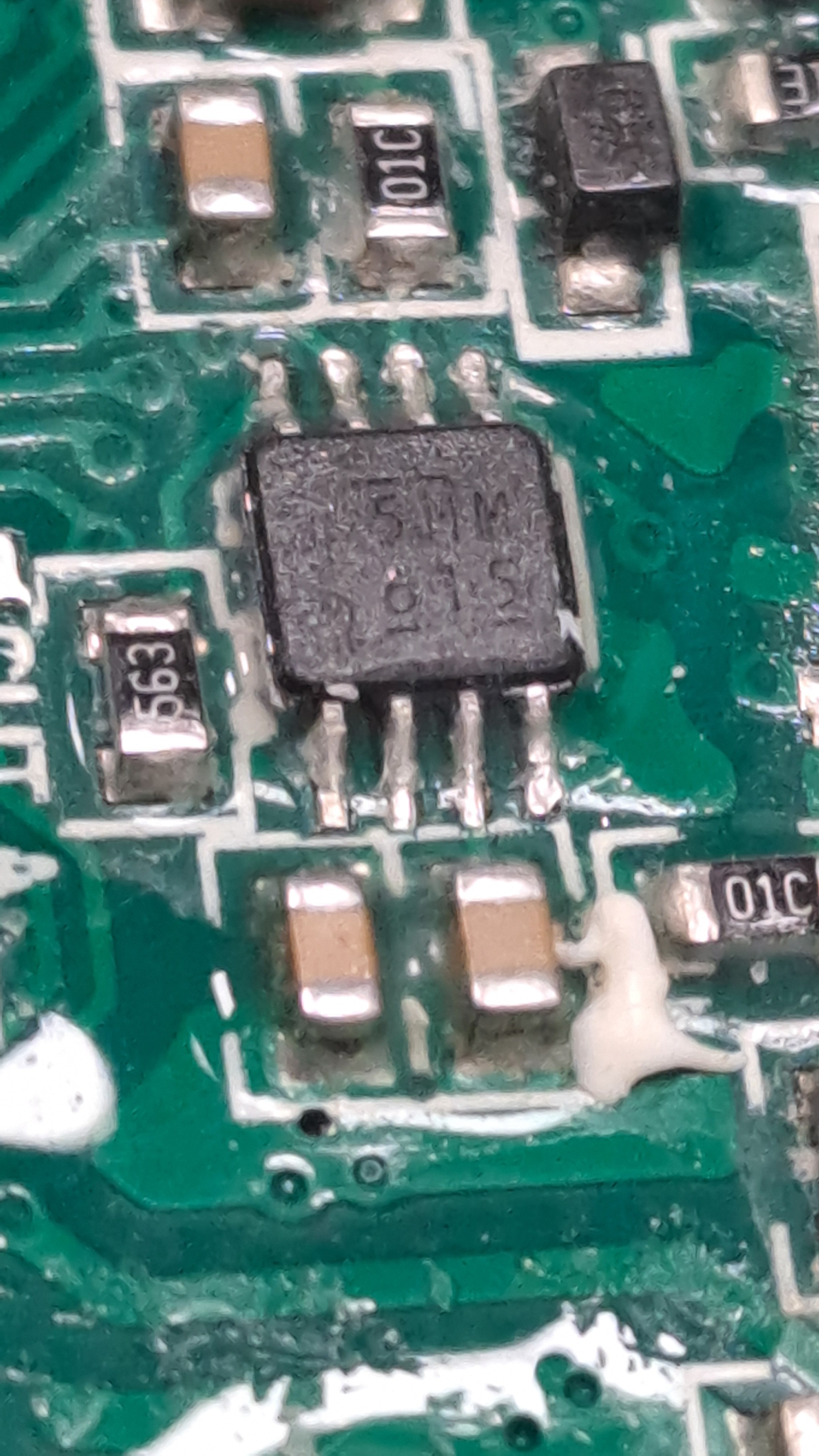

Wonderfull! And What about this chip? I read 5mm 615…

The picture is not clear.
If one letter is incorrect, the search is not possible.
Where is this chip installed?
It is installed in a phylion smart bms for ebike battery
This chip is not clean.
Please, clean it and take a new photo.
I’ve cleaned it
The marking is SHM 615
Hello Salvatore,
I think it’s some kind of a memory chip. I found some that had a suffix of SHM but nothing with the 615. Its likely that the 615 mark isn’t part of the part number. The package case is 8 SOIC. Some in that package case with SHM suffix memory chips we have are in link below:
Sorry I could not narrow it down any further.

Maybe 5HM?
Is there a logo on the chip?
In any case, a good quality photo is needed.
It appears to me more 5MM 615
Please check the attached photo
Unfortunately, the photo is not clear.
I am trying to help you, but even a single digit error will not give a positive result.
Desolder the chip, clean it thoroughly.
Show a photo of the entire board.
Did some searching on 5MM , 5HM and I still am not able to find any information on these markings.
It could be a shielded inductor. Give a look to attache datasheet from Wurth
