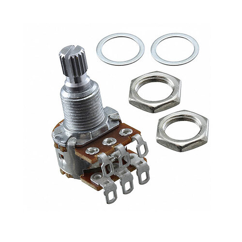

Thank you for your help first off! What do mean by M and N and the pot won’t work because it’s way to short. Plus please explain the 250k vs 100k. Here is a photo of what Parts Connection sent me and said it would work.
Thank you!
Mike
That’s the taper of the balance potentiometer. This is weird dual pot taper where the pots change in opposite directions and are at zero ohms in the center balance position. See data sheet and this:
My answer:
If they sat it will work and it doesn’t cost too much, or they offer a money back return guarantee, then you should try it.
