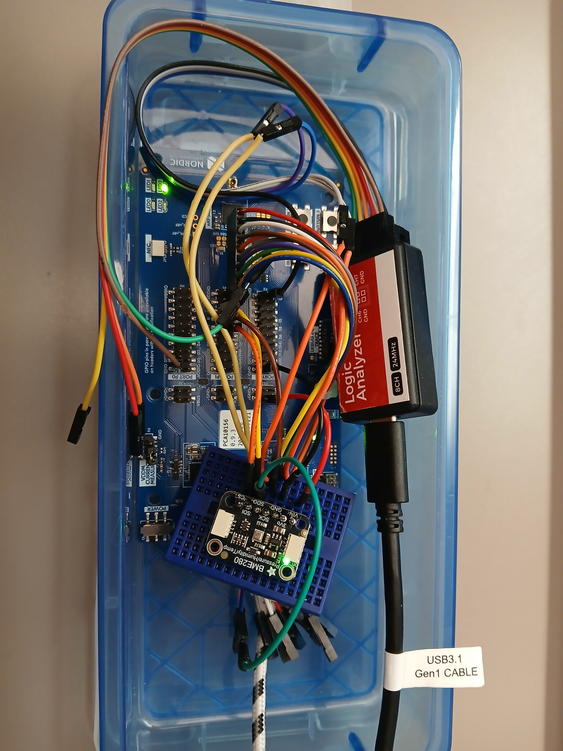

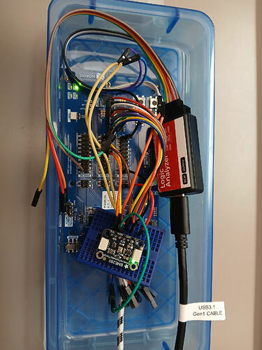

This article will describe how to create a Zephyr IoT weather station using the Nordic nRF54L15-DK development kit
connected to an Adafruit BME280 Humidity + Barometric Pressure + Temperature Sensor Breakout Evaluation Board available from DigiKey.
This Adafruit BME280 Humidity + Barometric Pressure + Temperature Sensor Breakout Evaluation Board contains a Bosch BME 280 sensor that in this case is used to communicate via 4-wire SPI interface at 1 MHz. The Bosch BME 280 sensor can also be interfaced via I2C and this board has the QWIC provision (Please see previous Zephyr I2C interface article in case this interface is used). The Adafruit BME280 Humidity + Barometric Pressure + Temperature Sensor Breakout Evaluation Board was soldered to the pins and attached to a breadboard similar to this one available from DigiKey,
The following color coded jumper wires,
were used to make the interconnections between the breadboard and the Nordic nRF54L15-DK development kit.
Before attempting to complete this Zephyr IoT weather station demo, please refer to the following article that describes how to install the software tools needed to develop in Zephyr using a Linux host. Here is the setup with the Sparkfun Logic Analyzer used in this case (Not the optimum one due to long cables, etc),

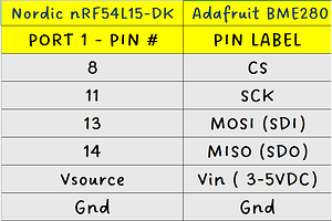

The 4 wire SPI interface connections plus the voltage source line and ground for this demo are summarized as follows,

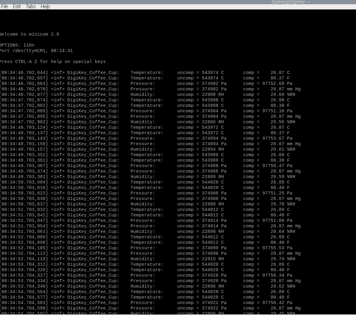

The following Zephyr weather station IoT application file called main.c will read the values from the Adafruit BME280 Humidity + Barometric Pressure + Temperature Sensor Breakout Evaluation Board once per second, plus blinks a green LED in the board too,

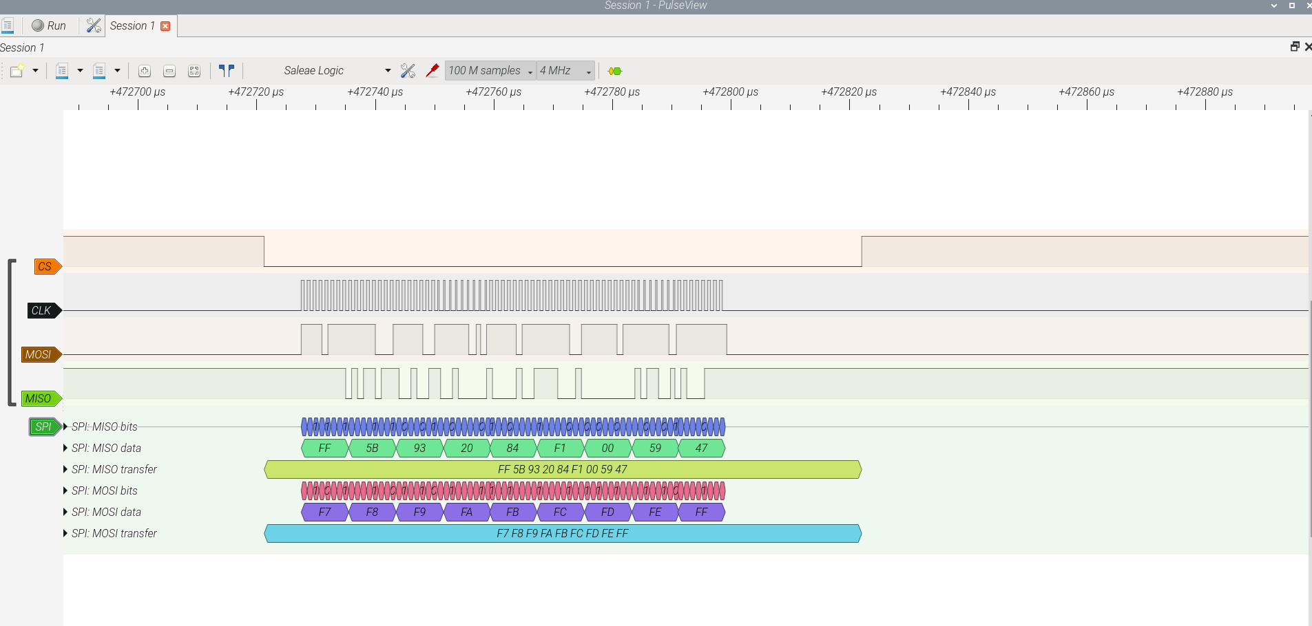

static int bme_read_reg(uint8_t reg, uint8_t *data, uint8_t size)
	int err;
	/* STEP 4.1 - Set the transmit and receive buffers */
	uint8_t tx_buffer = reg;
	struct spi_buf tx_spi_buf			= {.buf = (void *)&tx_buffer, .len = 1};
	struct spi_buf_set tx_spi_buf_set 	= {.buffers = &tx_spi_buf, .count = 1};
	struct spi_buf rx_spi_bufs 			= {.buf = data, .len = size};
	struct spi_buf_set rx_spi_buf_set	= {.buffers = &rx_spi_bufs, .count = 1};
	/* STEP 4.2 - Call the transceive function */
	err = spi_transceive_dt(&spispec, &tx_spi_buf_set, &rx_spi_buf_set);

This Zephyr IoT weather station program performs the classical Bosch BME 280 sensor compensations during the initialization stage and then proceeds to read the temperature, humidity and atmospheric pressure values from the sensor and toggles a green LED in the board once per second. This program also performs some classical conversions to display floating point weather parameters in different units. (That is why CONFIG_CBPRINTF_FP_SUPPORT=y is needed).
At this moment, open a minicom terminal to see the weather parameters that are being acquired by the Nordic nRF54L15-DK development kit as follows,
digikey_coffee_cup@digikey:~ $ minicom -D /dev/ttyACM1
The Sparkfun Logic Analyzer was used in the 4 wire SPI interface to monitor these messages as follows. The first snapshot shows all the messages interchanged during the initialization, compensation stage and reading calibration registers from the device,
Here is a closer look at one of the 4 wire SPI interface messages (PRESSMSB, PRESSLSB, PRESSXLSB, TEMPMSB, TEMPLSB, TEMPXLSB, HUMMSB, HUMLSB, DUMMY) 9 Bytes being queried once per second by the Nordic nRF54L15-DK development kit running the Zephyr application located at the addresses,
#define PRESSMSB		0xF7
#define PRESSLSB		0xF8
#define PRESSXLSB		0xF9
#define TEMPMSB			0xFA
#define TEMPLSB			0xFB
#define TEMPXLSB		0xFC
#define HUMMSB			0xFD
#define HUMLSB			0xFE
#define DUMMY			0xFF
clearly seen in the MOSI line and the corresponding bytes received via the MISO line,
