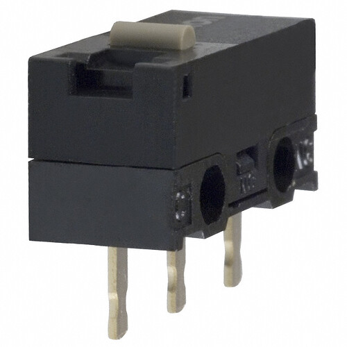

I have these switches:
I would like to connect the ends to wires without having to solder them.
Is there an appropriate crimp connector that would fit these pins, or some other item I’m not aware of?
Thanks for your help.
Hello FlabbergastedFinch, Welcome to the DigiKey TechForum. Unfortunately the only termination I can find for this series is solder lug or pc pin and there isn’t a crimp style connector that I am aware of, sorry for the inconvenience.
Thanks for the reply. I guess no crimp connector is sized to fit PC Pins?
Is there a product you attach to a PC Pin which you can then crimp to or screw a wire into. Basically a PC Pin to screw terminal or crimp terminal adapter?
An option that may work would to use a bullet connector. The diameter of A100622CT-ND is 1.02mm so you may need to squeeze them a bit, but it may work.
