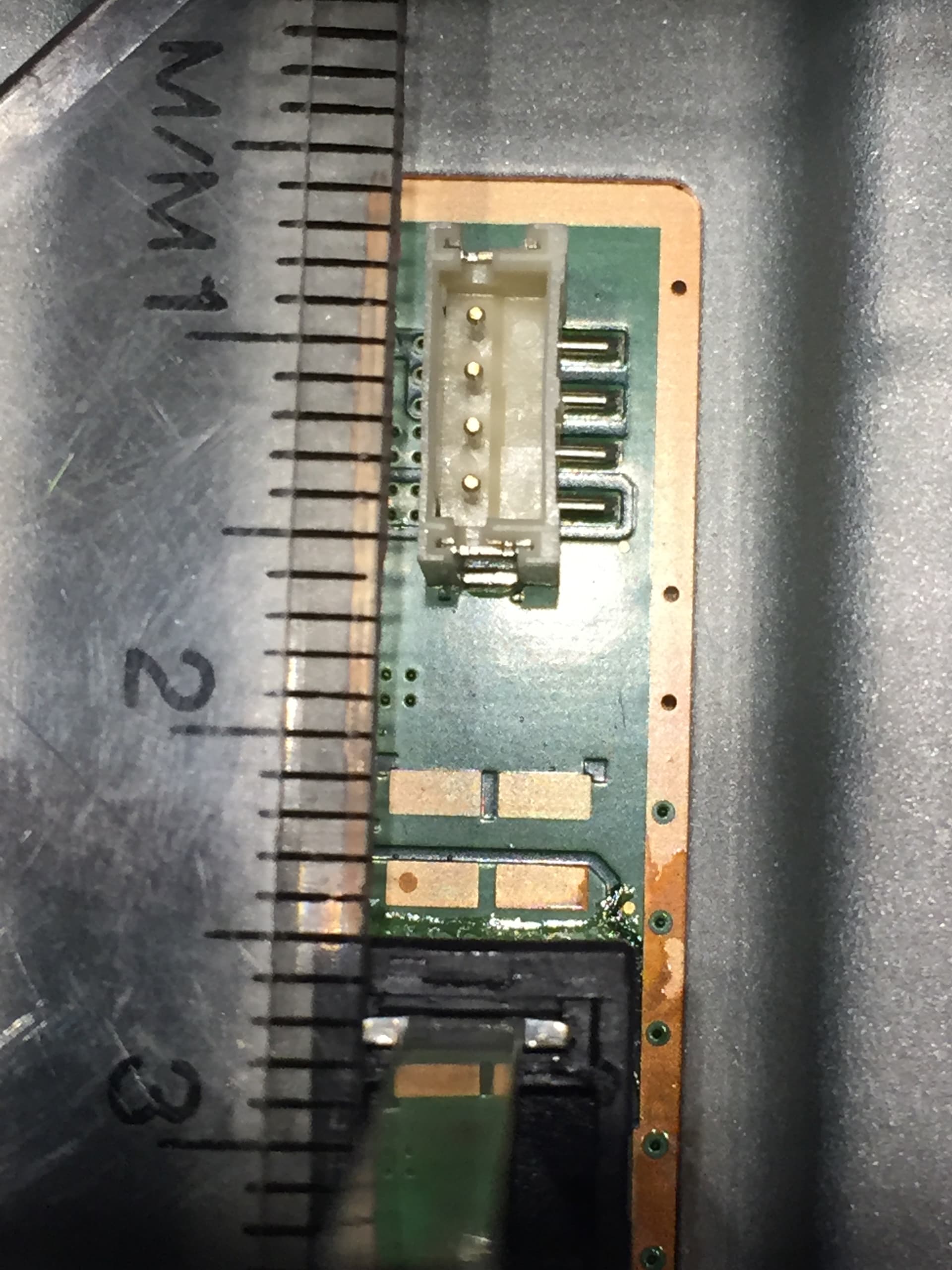

Hello, I broke the power supply to mother board cable of my PlayStation 4 pro, and I want un replacement cable.
Could you help me
You can see the picture of the cable and the femelle part on the mother board.

Take a look at A98655-ND. This part was mentioned on several “Fix-it” sites as the correct connector for the power supply of the mother board cable of a PlayStation 4 pro, We also have this connector on a cable assembly, which is Digi-key part number A100194-ND. Please take a look at the datasheet for the connector and make sure the dimensions match that of your connector, paying special attention to the pitch (center of one contact to the center of the next contact).

Welcome to the Digikey Technical Forum. I took a look for this part as well. I think I found something might work for you. Please look at the following.
I found this surface mount header in our system.
‎2057-15SH-A-04-TS-SMT-CT-ND‎
‎15SH-A-04-TS-SMT-T/R‎
Adam Tech
CONN HEADER SMD 4POS 1.5MM
https://www.digikey.com/en/products/detail/adam-tech/15SH-A-04-TS-SMT-T-R/10187339[1]
It mates with the connector. The image taken shows the back end where the wires enter.
‎2057-15CH-A-04-ND‎
‎15CH-A-04‎
Adam Tech
CONN RCPT HSG 4POS 1.50MM
https://www.digikey.com/en/products/detail/adam-tech/15CH-A-04/9830380
here is a picture of this same connector but with 5 positions. The point is you can see it has round openings.
2057-15CH-A-05-ND
This housing uses this terminal
2057-15CTA-RCT-ND‎
‎15CTA-R‎
Adam Tech
CONTACT 26-30 AWG CRIMP 1.5MM
https://www.digikey.com/en/products/detail/adam-tech/15CTA-R/10294528
