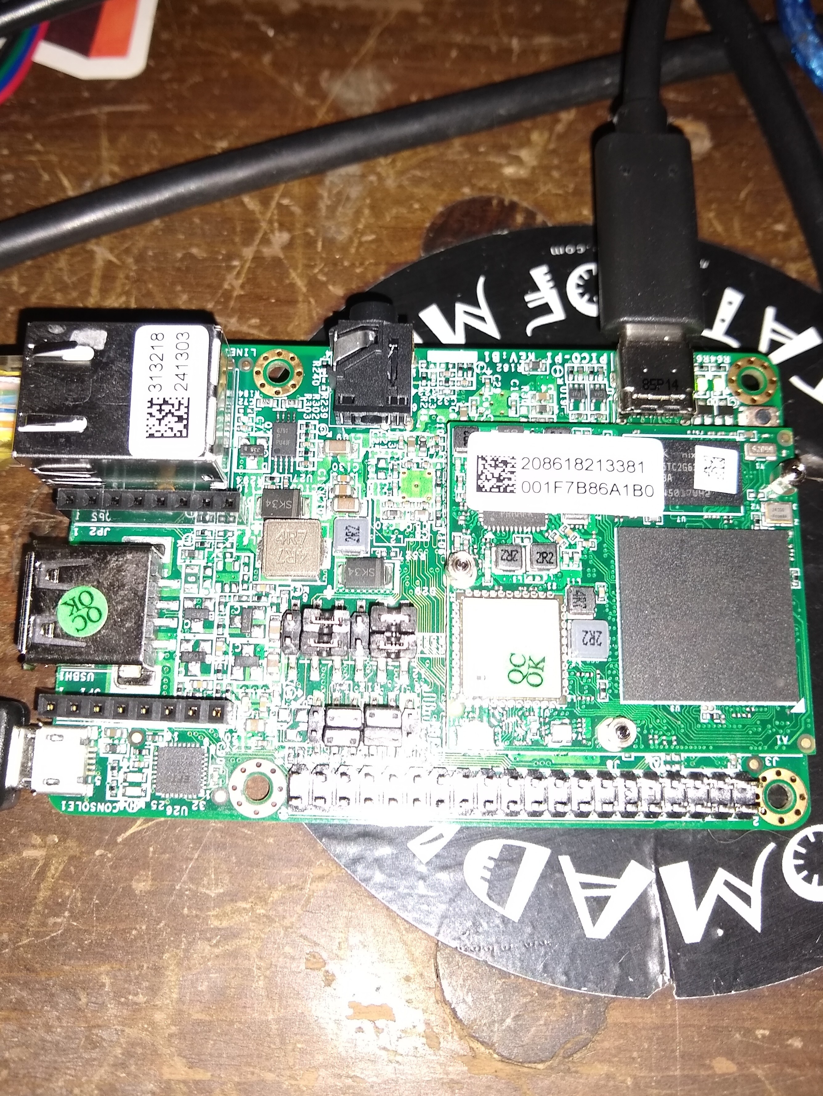

I figured that much, sort of. Anyway…please view this photo when you have time. It is of lsblk. Which item do you think is the actual PICO board?
Seth
P.S. Any response is much appreciated. I thought it would be sr0 but I can only get into u-boot w/ USB0 for some reason.

P.S. Here is the board: I could not show the LEDs b/c of the flash of the phone but only two LEDs near the USB-C cable are showing.
@silver2row this led? PICO-PI-IMX7-led Those two led’s only blink when there is tx/rx information being sent over the serial port.
Regards,
Yes Sir,
Those two do not blink on my end. One, the other one, just stays lit.
Seth
P.S. It stays lit while, well yesterday it did, I perform tasks. Today, the LED is out of commission. I have a Rev. B1.
I don’t believe your board is out of commission, verify that your serial terminal program is actually using the connected serial port. TIO for example will auto-connect/disconnect when the usb cable is plugged/unplugged. Some serial programs just lock up when they lose the serial connection.
