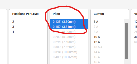

Hi, I need a solderable to board (Not plug-socket style) right-angle terminal-block.
As shown in this picture attached, or, it could be surface mount. 2,3,4 position ok.
Please advise.

Hi David, 3.81mm would be ideal, but will consider 3.50 or 2.54 mm
Hi Smart.Enrg,
It looks like @David_1768 has given the link to all of the options in the general form-factor you are looking for.
From there, just filter on pitch to narrow down to the pitch options you will consider.
Note that we do not appear to have any options with leads extending out the rear as far as your part appears to before turning down 90 degrees. So, you’ll need to measure the relevant dimensions in your part, such as the distance from where the pins angle down to either where the wire enters from the top or to the front face of the part, depending on what’s important for you, and then start looking at drawings of parts to see if any are close enough to work for you.
At first glance, the TE Connectivity 284415-x parts seem to be among the more likely options.
