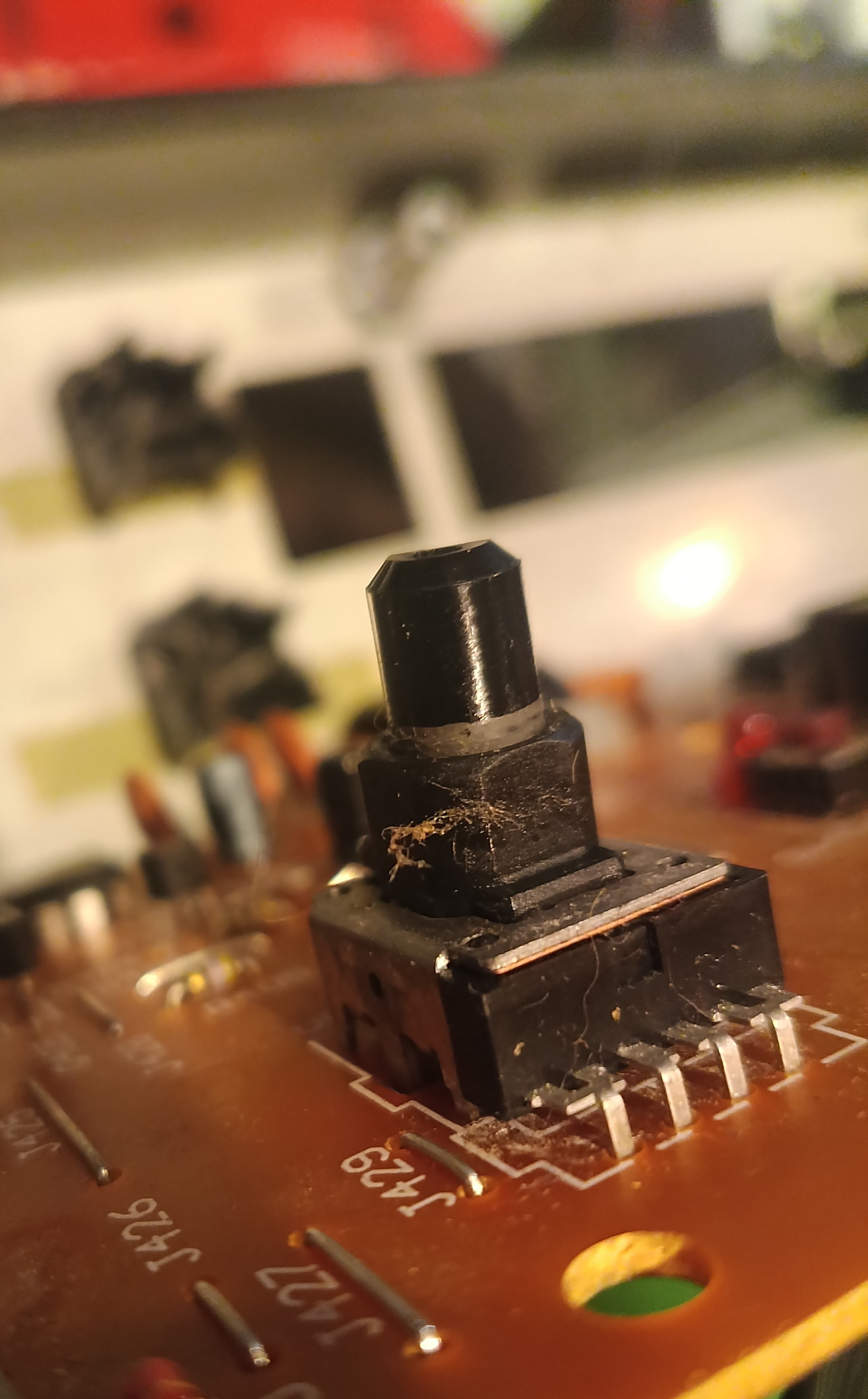

So finally a picture of the Overdrive pot.
It’s a 4 pins and not a 6 pins like the Roland guy said to me :person_facepalming:
So what could it be ?
Thanks
Here is differents angles
Hmmm, that’s goofy. It looks to me that they took a standard 6-pin dual pot and fused the outer 2 pins on each side together.
It also looks like they changed the pin spacing in the process. The standard Panasonic EVJ series parts have a 2mm pitch from pin to pin and the pin-out is as follows for all of the 6-pin parts that I found.
Assuming that they didn’t change the internal structure of the part and only fused the outer 2 pins together on each side (which may or may not be the case, though I think it likely), the pinout of your part would be like the following:
If this is what they did, then with some finagling, one might be able to make one of the 6-pin parts work, but no guarantees you’d be able to make it fit or even that the pinout I drew above is actually correct.

How possible is it that it is the below internals? With an odd external pin fuseing.
Rotary Potentiometers, Rheostats | Potentiometers, Variable Resistors | DigiKey
That is a possibility.
So, I should try one of the Ptt111 (mine is a 10K) ?
I honestly can’t say.
If you had access to a functional version of the original pot, you could test it with a multimeter while moving the knob to see how the resistance values change as the knob is rotated, and from this, figure out whether it has the internal structure of the PTT 111 type or the structure I drew above, or something else.
Short of being able to test a functional part, I don’t know of how to determine which structure described above, or another one, is the right choice.
You could order one or more of the potential options and try them out. However, there is always a possibility that the wrong type could damage it. I think that is not likely, but always a possibility.
