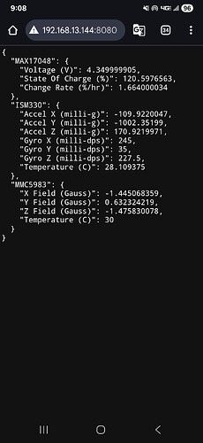

Any other device connected to the WiFi router in the LAN can access the SparkFun DataLogger IoT - 9DoF. In the terminal the MAX17048 micropower current fuel gauge, the ST ISM330 accelerometer/gyro inertial module and the High Performance 3-axis Magnetic Sensor. data from each device data via a web browser, for example if it’s connected to a WiFi Hotspot in the cellphone as shown below,
the data will be updated when the web browser is refreshed. Now any Android OS Developer can easily use this data to develop IoT applications in the cellphone.
