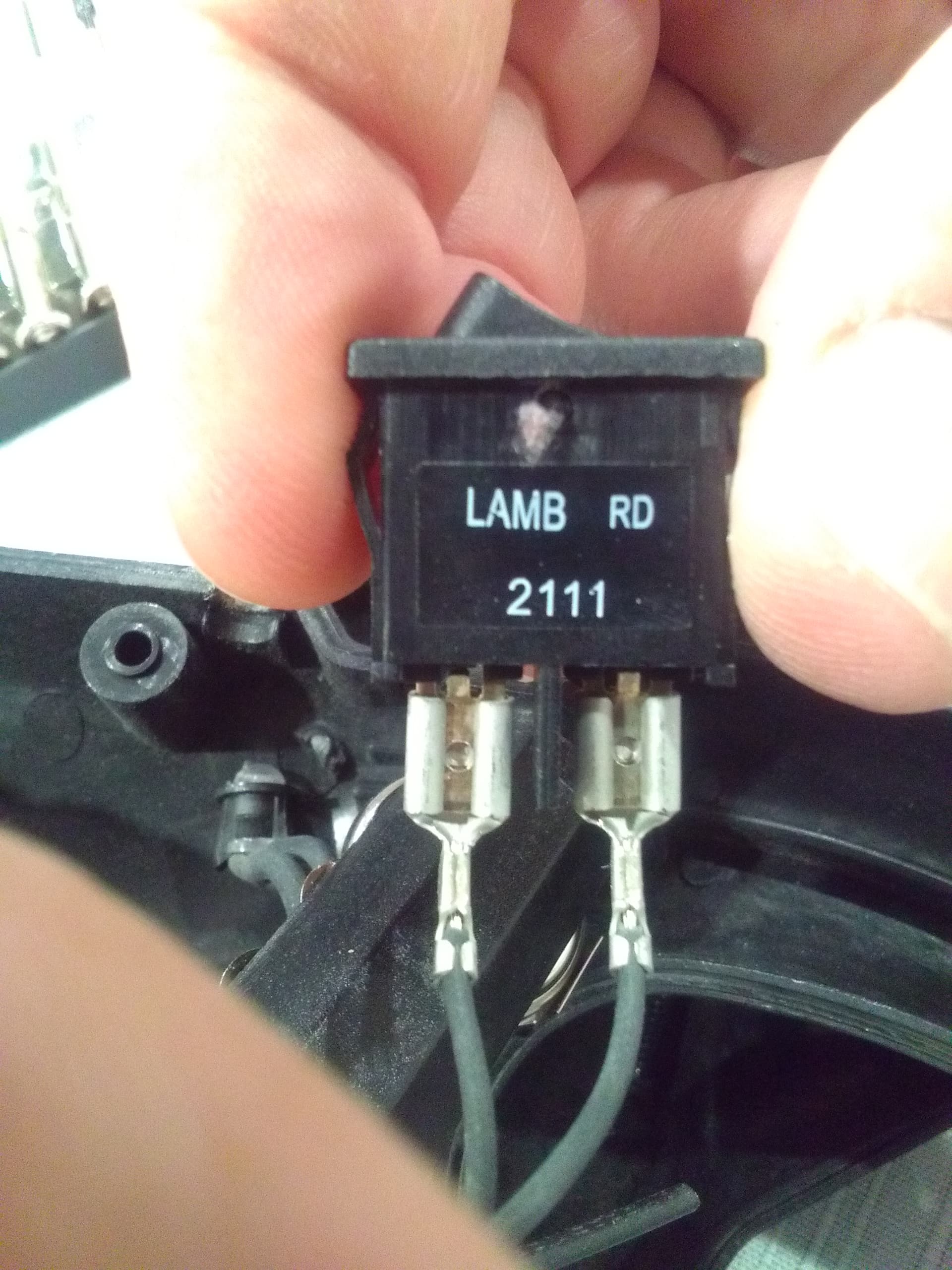

Need a Equivalent Switch (Old Switch is labeled “LAMB RD 2111”)
Please share photos you have of the switch. Any electrical ratings that may be marked. How many terminals does the switch have? If this is panel mounted what is the hole cutout size measurements?

They all look the same. I guess I may have to take out original check the details.
I was wandering what does the “2111” stand for
That is likely the date and lot the switch was manufactured in. Traceability information.

I will get the actual switch for more technical details, such as size dimensions
The switch is actually for a RF activated Vacuum Pistol Grip Wand
It uses to 2032-3V batteries and it has this switch I want to replace
The important dimension is the panel hole cutout for switches I linked is Rectangular - 19.20mm x 6.80mm ( 0.756inch x 0.268inch )
with that low of voltage/current any of the switches I linked to would work if they fit and you need an On-Off type switch.
