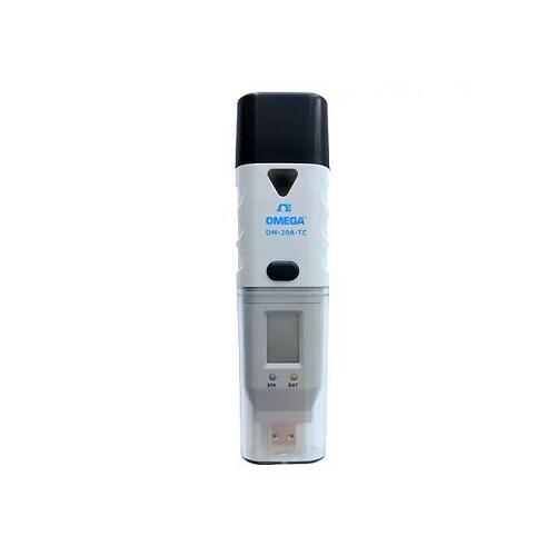

Looking for a standalone temperature data logger to measure temperature of hot metal surfaces up to 300 deg. C. I can think of DS1922E is the closest match but temp range is not suitable. Kindly suggest suitable option ASAP.
Hello @dhananjay.gadgil,
Wlecome to the TechForum!
The iButton DS1922E is a beautiful solution, but it will not handle your applications 300°C requirement.
There are many solutions ranging from custom microcontrollers to laboratory grade instruments. As a starting point, may I recommend this new product:
When combined with an appropriate thermocouple (sold separately) it will meet your temperature range.
Please let us know if you would like to further refine the search.
