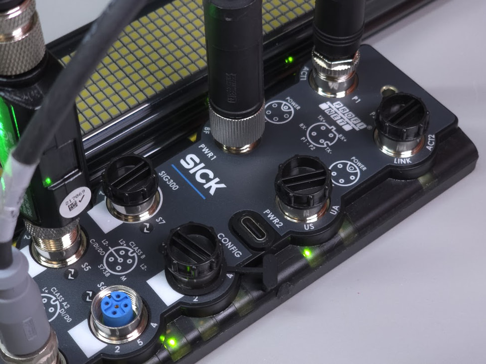

Figure 1: Image of a SICK SIG300 IO-Link master.
What is the purpose of the GSDML File?
  • The GSDML file is read by TIA Portal and serves as a menu-driven tool that you use to configure the IO-Link master.
  • The GSDML file is provided by the manufacturer of the IO-Link master. In this example, SICK provides the file for the SIG300 (Figure 1).
Tech Tip: Technically, the GSDML file is not part of the IEC 61131-9 IO-Link standard. Stated another way, the PLC never speaks IO-Link directly. For example, the PLC communicates with the SICK master shown in Figure 1 using PROFINET as defined by IEC 61158 and IEC 61784.

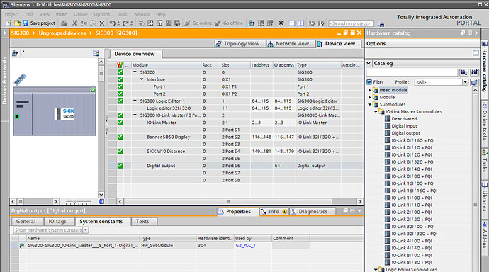

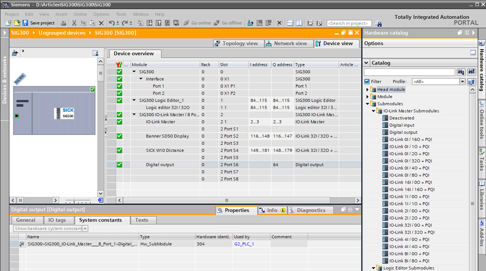

Figure 2 shows the configuration for the SIG300. The right-hand side presents the SIG300 options exposed to the PLC. The device overview describes the actual interface for the SIG300. The type column shows the actual port configuration such as digital output or IO-Link 32I/32O. Without the GSDML file there would be no right-hand submodules.
Figure 2: Instantiation of the SIG300 ports.

This is an important consideration for the GSDML. The device overview (Figure 2) identifies instantiated cyclic PNIO ports. This allows you, the programmer, to configure the IO-Link submodule once and then use it as if it were part of the PLC’s local IO.

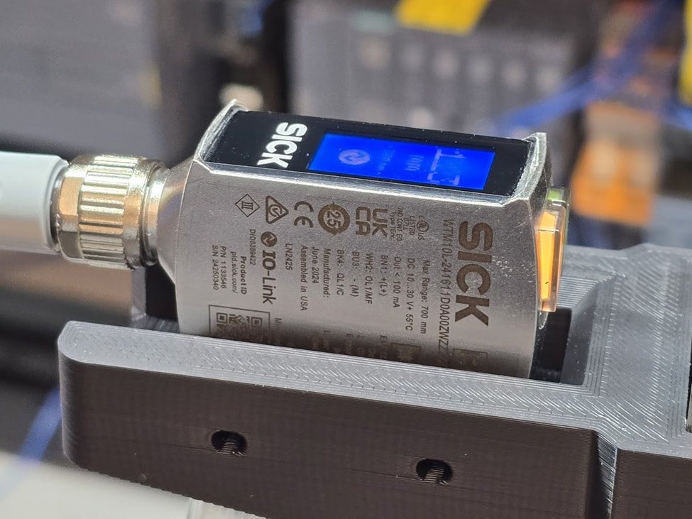

  • The IODD file is provided by the manufacturer of the individual field devices such as the SICK W10 distance sensor shown in Figure 3.
Figure 3: Image of the SICK W10 IO-Link equipped distance sensor.
How to Conceptualize the IODD File
While the sensor features a microcontroller, the IODD should not be confused with a register map.
The IODD describes the interface between the IO-Link master and the field device using the IEC 61131-9 protocol. Like the GSDML file, the IODD describes the exposed features. For example, the SICK W10 shown in Figure 3 contains a microcontroller that communicates using the single-wire bidirectional interface. The IODD file describes the configuration parameters and data that is shared across the physical (M12) connection.

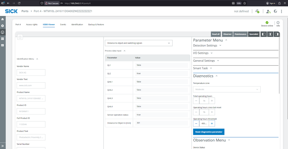

As an example, consider the Figure 4 IODD Viewer for the SICK W10 sensor. Note that we are logged into the USB service port of the device.
The SIG300 web server has built this entire page based on:
  • The sensor description contained within the IODD file.
  • The real-time data retrieved from the W10 sensor.
Consider the Distance to Object field (last field in the center column). The IODD file effectively told the SIG300 that this field existed. The SIG300 then pulled data from the sensor and populated the field. The SIG300 also makes this data available to the PLC via the PNIO submodule associated with port 4.
Tech Tip: Consult the field device literature to determine the memory size of the cyclic data. This essential thread runs from PLC to IO-Link master to field device to ensure that the data arrives quickly and fully intact for use by the PLC or vice versa.
Figure 4: Data from the SICK IODD Viewer for the W10 distance sensor.
