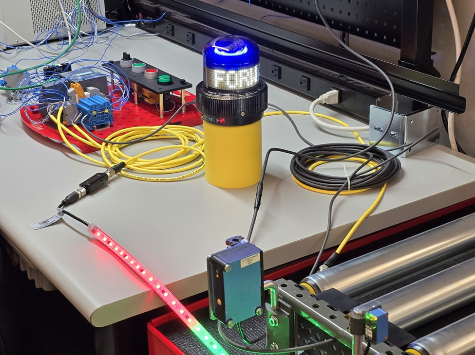

Siemens PLCs do not include native enums, but we can replicate them using global symbolic states names under the user constants tab of a PLC tag table. This is a case study using the conveyor and Banner K100 beacon shown in Figure 1.

Figure 1: Benchtop view of a conveyor section with Banner beacon and Siemens ET 200 in the background.

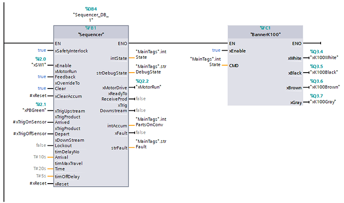

Figure 3 shows the blocks for the conveyor’s sequencer and the Ladder logic showing the conveyor sequencer and the BannerK100 Blocks. Observe that the sequencer exposes intState which is coupled to the tag MainTags.intState.
Listing 1 demonstrates the utility of the symbolic constants within the sequencer block. Figure 4 shows how they are used in the Banner K100 function. In this example, the K100 beacon’s black wire is driven if the conveyor is in the pre-arrival state of the running state.
Figure 3: Ladder logic showing the conveyor sequencer and the Banner K100 Blocks.
Tech Tip: Technically, intState is just another integer. It is the symbolic names that make it easy to remember across function blocks. Instead of remembering what happens in state 2, we can easily remember STATE_RUNNING.
Figure 4: Usage of the global state variables in the Banner K100 function.

Keep the program simple. After all, the sequencer is already too complex. We should pass the mapping task to the beacon function where it can be handled in a few lines of ladder logic as shown in Figure 4.
