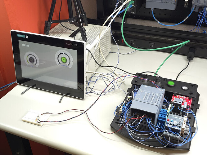

Figure 1: PID project on the author’s workbench showing PLC, HMI, and the heater / sensor installed on a breadboard.

Figure 1 shows the project on the workbench. The LM335 temperature sensor and 1 kΩ resistive heater simulate a larger industrial system. Our mini plant operates at 25 VDC and has a fast time constant. It’s more convenient than a real world system such as a 1000 gallon tank with a heater controlled by a three-phase 460 VAC SCR chopper.

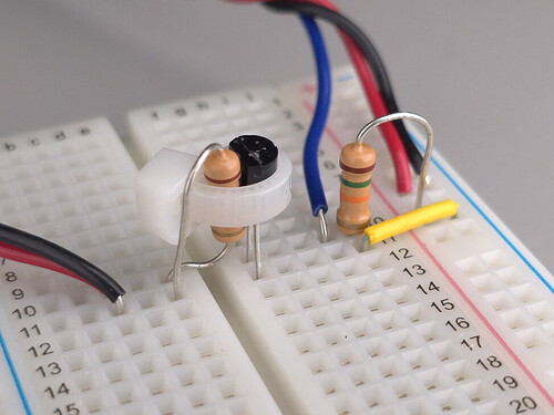

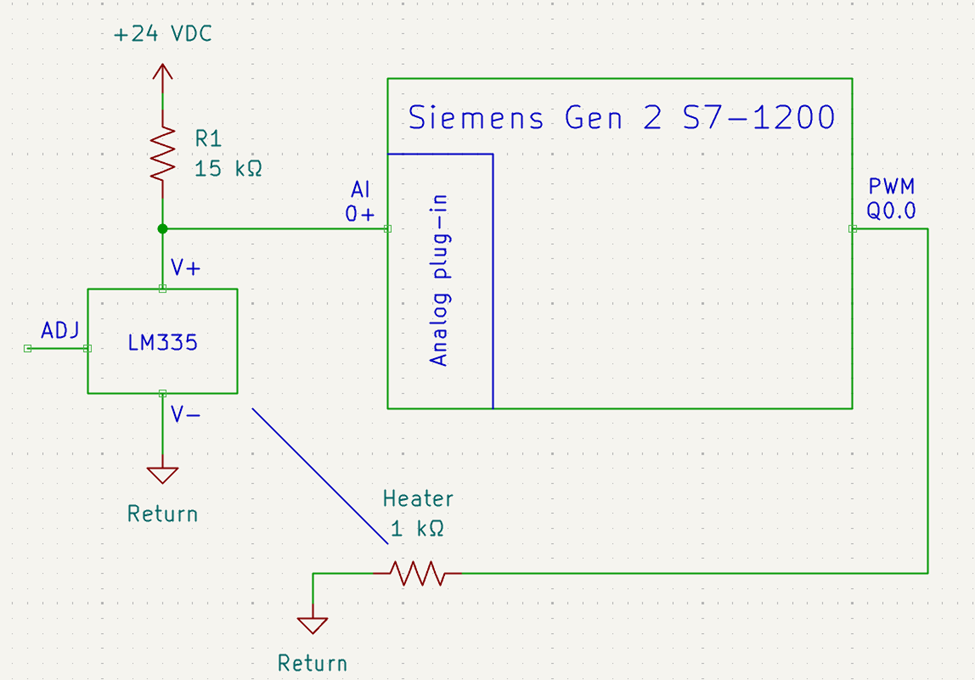

The thermal plant is shown in Figure 2, where we see the 1 kΩ heater tie wrapped to the LM335 sensor. The 15 kΩ biasing resistor is seen in the background. The accompanying wire diagram is shown in Figure 3.
Figure 2: Image of the thermal system with heater tie wrapped to the temperature sensor.
Figure 3: Wire diagram for the PLC-based thermal system.

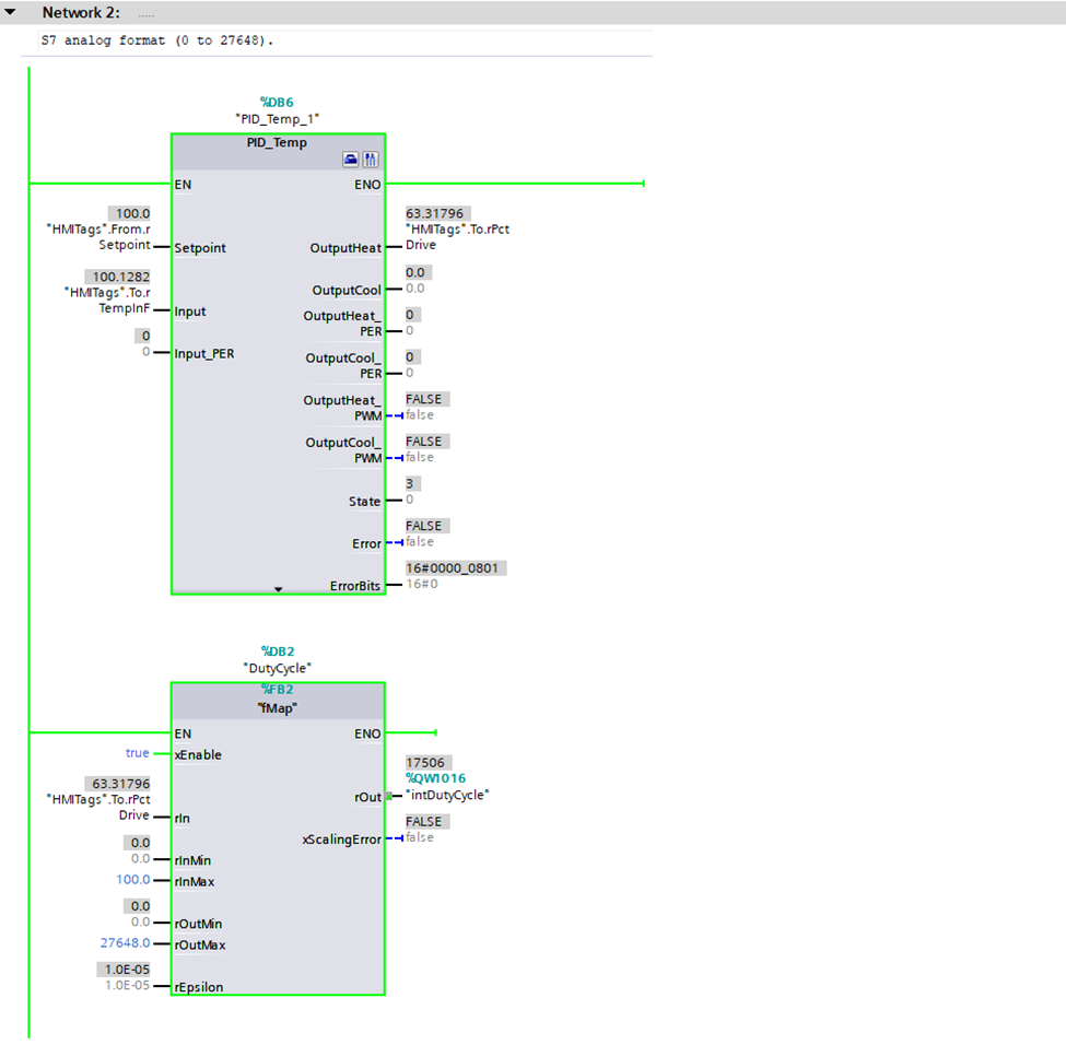

The Siemens PID_Temp technical object handles the classic analog PID routines. However, it does need a few rungs of helper code.

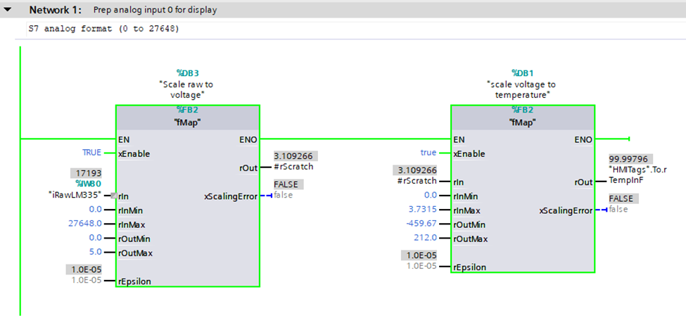

Scale the Input
Figure 4 presents the analog scaling blocks which are used to convert the raw LM335 sensor data into a human readable Fahrenheit value.
The raw ADC value is converted to its equivalent voltage where the ADC value 0227,648 maps to 5.0 VDC.
The voltage held in rScratch is then converted to a Fahrenheit temperature. Knowing that the LM335 is configured for 10 mV/K we use a convenient number scaling from absolute zero to boiling water where 0 to 3.7315 maps to -459.67 to 212.0.
Figure 4: Scale the LM335 temperature sensor to a voltage and to the Fahrenheit equivalent.
Tech Tip: Figure 4 breaks the scaling into two steps. It first converts the raw ADC to a voltage (rScratch) then it performs a second conversion to Fahrenheit. This intermediate value is useful for development and troubleshooting. For example, the rScratch value will match the value measured via a multimeter placed on the sensor’s terminals.
You decide if readability and easy troubleshooting are with the extra memory usage and the slightly reduced loop speed.
Set the PWM
The PID_Temp technical object is shown in Figure 5. The operator sets the setpoint in the HMI and the feedback (input) is the scaled LM335 temperature in Fahrenheit. The OutputHeat value is sent to a scaling block which maps the percent drive to the S7 analog format used to drive the PWM. The 0 to 100.0 percent maps to 0 to 27,648.
Figure 5: Ladder logic code including the PID_Temp technical object and output scaling block.

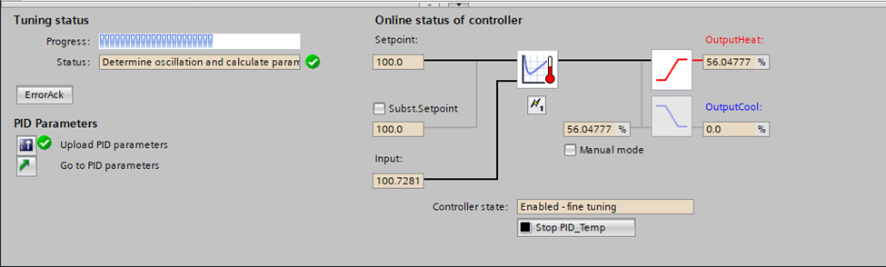

Tuning Status (Figure 7): The PID controller has two inputs (setpoint and feedback) and two outputs showing the percent drive for the heating and cooling mechanisms. A progress indicator shows the status of the auto tuning. It also has a few controls allowing on-the-fly change of setpoint and an override for the plant’s percent duty cycle output.

Figure 7: Control panel for the PID_Temp technical object shown in the automatic tuning process.

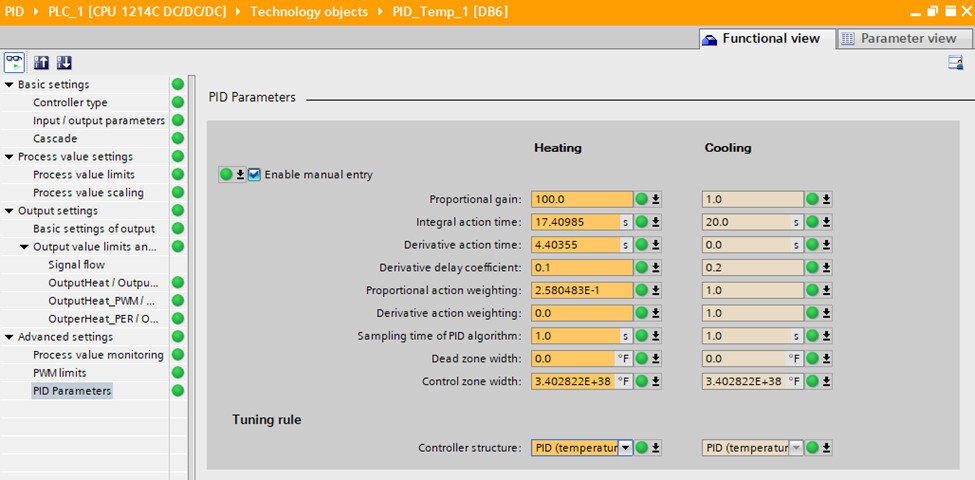

However, if I were your teacher, I would insist that you roll your own as described in the prerequisite articles. You need the school of hard knocks to truly understand the impact of the tuning parameters. As a compromise you could manually tune the PID using the controls shown in Figure 10. In this case, I’ve manually set the gain to 100.0 causing the system to oscillate.

Figure 10: PID tuning parameters with the proportional gain manually forced to 100.0.
