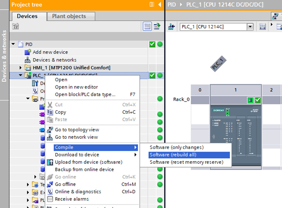

Compile and then Download the Hardware Changes
Update the hardware by first compiling as shown in Figure 3. Then select “download to device” to apply the changes to the PLC.
Figure 3: Location of the PLC hardware compilation instruction in TIA Portal.
