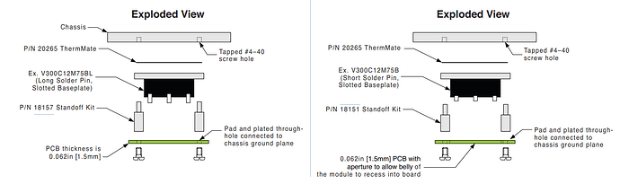

I searched our system for a Vicor spacer, for the Mini series, and I found a standoff kit.
That part number is 18151-ND.
Please check the datasheet and see if this is the item you are looking for.

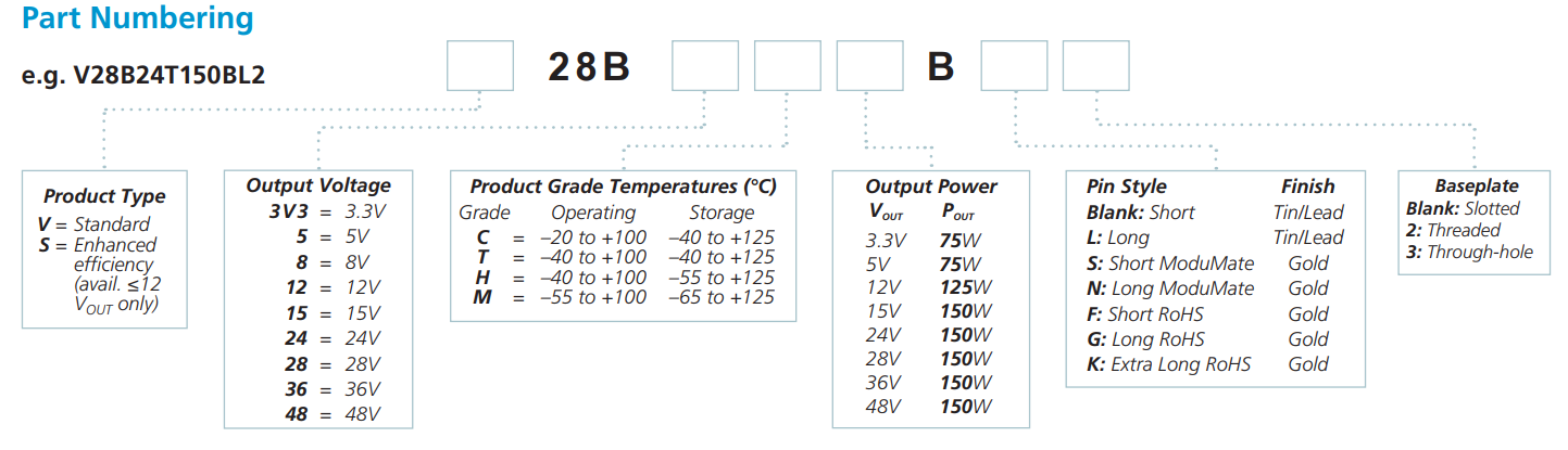

The 18151-ND is for the short pin variant of the module, where as the 18157 is the kit of the long pin variant. The information for the kits is available in the design guide.
For the V28B24T150BG2 the G calls out long pin with Gold finish.
