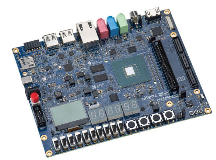

DE-25 FPGA Dev Kit Part 10 (JTAG Indirect Configuration File)
The purpose of this article is to outline how to program to the Quad Serial Peripheral Interface (QSPI) NOR flash non-volatile configuration memory device in the DE-25 FPGA Dev Kit.

To program the QSPI non-volatile storage, please configure the following switches as follows to place it in Active Serial (AS) programming mode,
Assuming that the DE-25 FPGA Dev Kit is powered on, the USB cable is connected to the host, and the SRAM Object File (.sof) in this case top.sof has been generated properly, first proceed to use the following command in the directory where the top.sof file resides to convert it to top.jic,

Turn the power off and on of the DE-25 FPGA Dev Kit again to check whether your design is still running on the FPGA. The FPGA should be implementing the intended system via the QSPI after the power cycle process. This has completed the description of the conversion from top.sof to top.jic and how to upload it to the QSPI device in Active Serial Programming mode.
The DE-25 FPGA Dev Kit is a powerful platform featuring an HPS/FPGA Agilex 5 (available as D-Series and E-Series depending on the case) capable of implementing Tensor AI slices,
