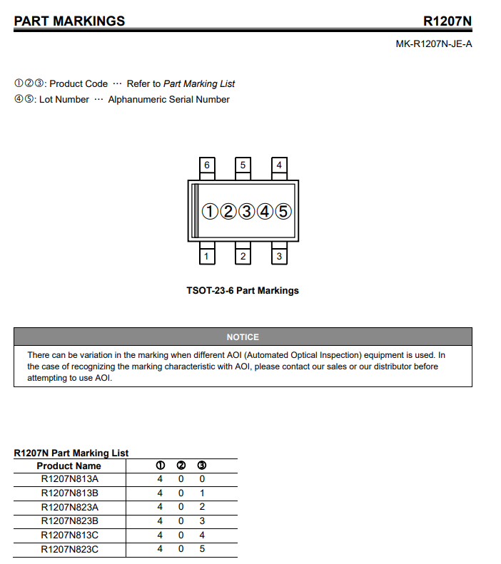

I need a hand identifying this DC buck converter. The circuit converts 12v to 5v. I’m guessing it’s a buck based on the proximity to the inductor. The marking on the part is 405V1. It has 6 pins, I think maybe it’s an sot23-6? It’s the black IC in the center of the frame

from what I was able to find on those part markings, it looks to be part number R1207N823C-TR-FE
You’re amazing! Thanks!
