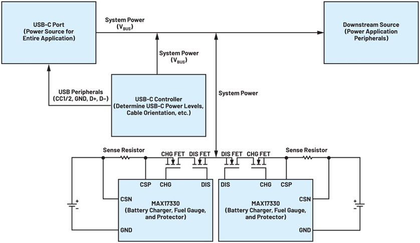

Implementing USB-C Parallel Charging with the MAX17330
Figure 2 shows an example of one of the main tools needed to create a parallel battery charging environment—the MAX17330. This IC acts as a battery charger, fuel gauge, and protector all in one. The MAX17330 receives power from a USB-C-compatible charger or converter, enabling it to charge parallel battery packs at high speeds. This configuration especially allows users to have the most hands-on usage time as possible.
An added advantage of using the MAX17330 is the flexibility of battery placement. For instance, in AR/VR headsets or foldable phones, batteries can be positioned on opposite sides of the device.
Some of the key benefits of the MAX17330 include:
- Minimizing dropout and heat
- Preventing cross-charging between parallel batteries
- Allowing independent charging of each pack
