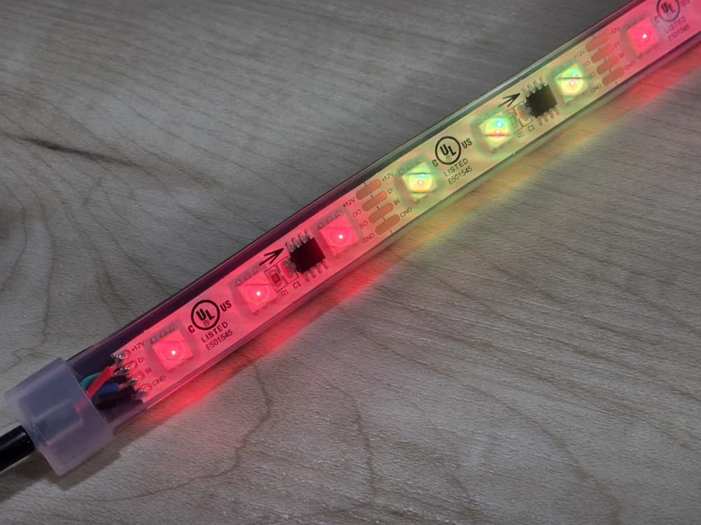

What’s inside the WLF12?
The WLF12 is constructed as a series of addressable drivers and multicolor LEDs as shown in Figure 2. The RGB LED driver chip is a WS2818B. It receives data over a serial bus and provides a Pulse Width Modulated (PWM) output signal to drive the LED segments.
Each controller drives three parallel-connected LEDs. Consequently, the LEDs are controlled as a trio as evident in Figure 2, which shows a red/yellow color with three LED segments each. Single LED control is not possible with this configuration.
Figure 2: Two 8-pin driver chips are seen in this image of the Banner LED strip.
