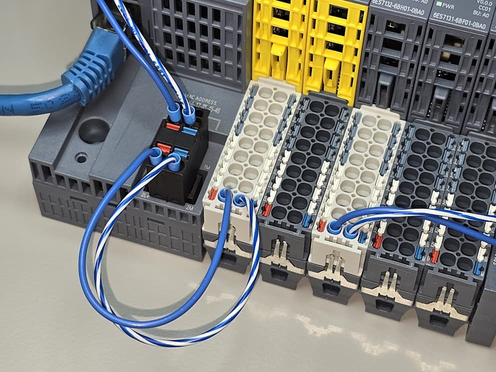

Representative base units are shown in Figure 1, including:
White: New potential group (load group) base unit type 6ES7 193-6BP00-0DA0.
Gray: Standard base unit type 6ES7 193-6BP00-0BA0.

Figure 1: Close up view of the ET 200SP base units showing a daisy chain connection to the first base unit.

The White BU do not Accept Power
A lack of power connection prevent the white BU from accepting power from the bus. Look closely at Figure 3, we see that the white BU has no copper contacts for the left side (power pickup). Consequently, the white (new load) base units provide isolation between power sections.
Figure 3: There are no power input connections in the white base unit.
Tech Tip: The first base unit immediately following the ET 200SP interface module should be a white (new load group) type. To be sure, we can power a gray unit via the power connections (Figure 1). However, there is something to be said about following the convention implicit in the Siemens design.
The white modules must be directly connected to the power source.
The gray modules power connection should be unconnected, as the gray modules receive power from the white new load group module to the left.
