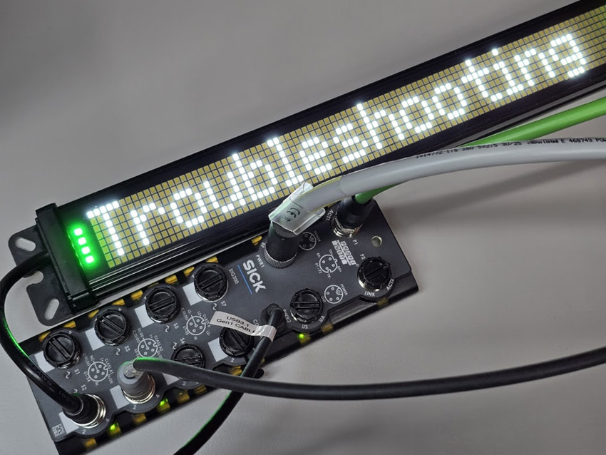

The SICK SIG300 demonstrates this pain point (Figure 2). While it has eight A-coded connectors there are three different types. All are IO-Link capable but differ in their digital I/O capability:
  • Class A1: Ports S1 through S4 expose 4-pins including 24 VDC, return, and two bidirectional signaling ports.
  • Class A2: Ports S5 and S6 expose all 5 pins including 24 VDC, return, and three bidirectional signaling ports. A configuration window is included as Figure 3 showing pins 2 and 4 as digital outputs and pin 5 as a digital input.
  • Class B: Ports S7 and S8 are high power ports capable of providing up to 2A. All 5 pins are exposed including 2 pins for 24 VDC, 2 pins for return, and a signal wire. Recall that a class B port doubles the power conductors for increased current capability.
This presents a system configuration problem with long term complications for system expansion. It’s a resource constraint problem as there is a limited amount of I/O. If we mistakenly assume all 5 pins are exposed, we end up 8 I/O ports less than expected.
Figure 2: This SICK SIG300 includes eight A-coded M12 connectors.
