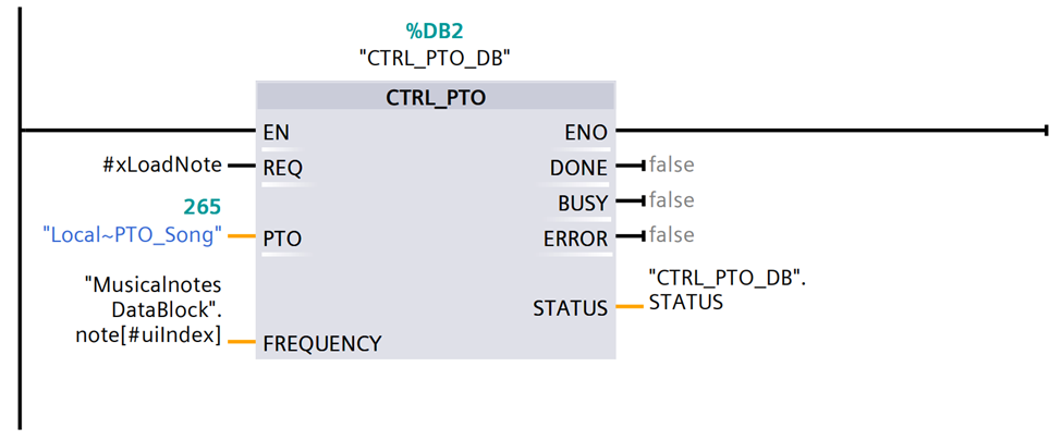

The Siemens S7-1200 includes pulse generators that can be configured for Pulse Train Output (PTO) or Pulse Width Modulation (PWM). In this application, we use the PTO as it allows dynamic frequency adjustment while maintaining a 50% duty cycle. The instantiation is shown in Figure 2. There we observe the indirect addressing of musicalNotesDatBlock.note[#uiIndex]. Note that uiIndex is a pointer to the next note while a rising edge on xLoadNote will transfer the note to the PTO block.
Please refer to this link for instructions to configure the Siemens PTO.
The code for the music UDFB may be downloaded in pdf form. It’s a relatively straightforward approach to generate a pulse every timNote seconds. This pulse is used to increment uiIndex and to load a new value in the PTO block. Finally, a guard is used to reset uiIndex at the end of the song.
playSong.pdf (75.7 KB)
MusicalNotesDataBlock.db (3.2 KB)
Figure 2: Instantiation of the Siemens PTO hardware to play the musical notes.
