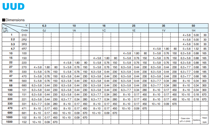

Middle: This is a Nichicon UUD Series 47uF 25V Cap. Look at part 493-2273-1-ND

Thanks for the quick reply, couple of questions;
Middle: I read somewhere that 470 represents 47uF (471 represents 470uF) is it true? Im so confused.
Next question, does it matter which series I use? Are they interchangeable? And does the polarity matter?
@Aremean,
Yes, this is correct however not always true. Often it is based on the series and if there are options for both values or not and how much space. There is a diagram in the datasheet that confirms your thinking.
Series are interchangable, the key is making sure the landing pads on the board are the same if you are replacing bad capacitors. As for polarity it is 100% important that they are installed in the correct orientation.
-Robert
Wow… so many new things to learn. Thanks!
So can I comfirm that from my middle picture, the one I need is 470uF and not 47uF?
Thanks again
In this case it would be a 47uF per the diagram above. The link from my post should be correct and I have updated it to say 47 and not 470.

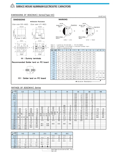

Hi all hoping you can help identify a cap or 2 so I can check the data sheets…
They are from a 2007 model year Samsung LCD TV

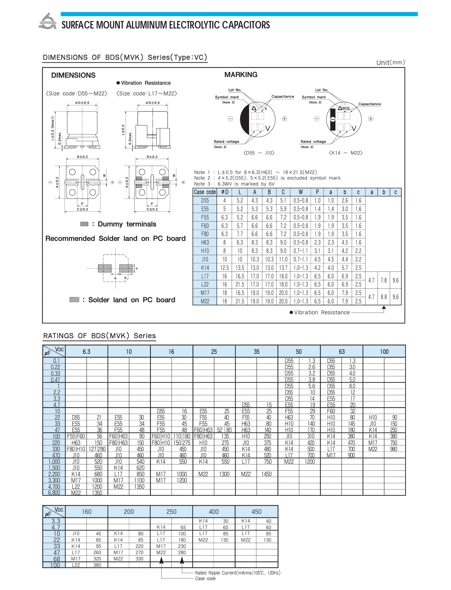

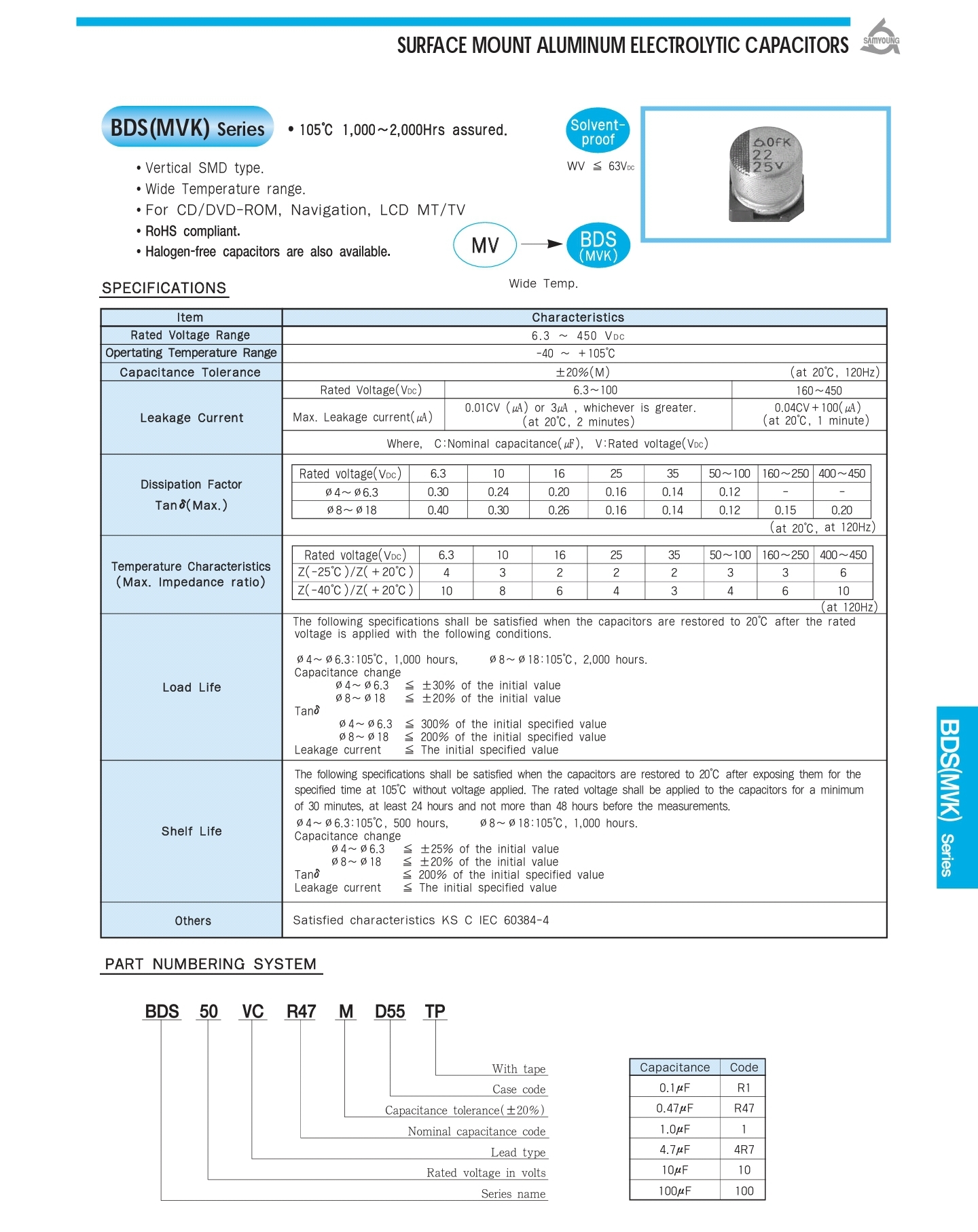

I think the first 1 is a Samyoung 1000uF 10v, potentially BDS(MVK) series.
The cap…
20200102_234235
The possible spec (highlighted) from the service manual (I don’t currently have the board, so I’m taking a stab at the part number on the board)
I don’t understand what the WT means
Screenshot_20200102-232149_Acrobat for Samsung
And the “possible” datasheet
Continuing here as I’m restricted to 3 images per post
