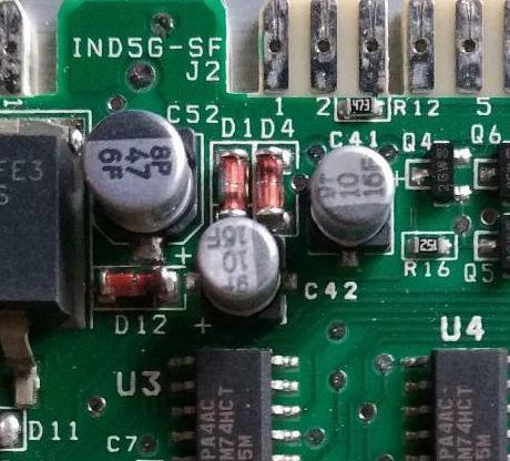

Hi all!
I am new to this forum and hoping someone can help me identify which replacement parts I need for this please?
The capacitors read:
8P
47
6F
and:
9T
10
16F
Any help, much appreciated and thank you in advance for your support!
capacitors
I believe the first is a 47uF, 6.3V. I do not know the dimensions, but you can choose from this link - https://www.digikey.com/short/dwqvcmnj
I believe the second is 10UF, 16V. Again, I do not know the dimensions, but you can choose from this link - https://www.digikey.com/short/zpcfntvc
Thank you so much for your help!
The bigger one is around:
Diameter 5mm
Height 5mm
The smaller ones are around:
Diameter 3.5mm
Height 5mm
For the larger, you can select from here - https://www.digikey.com/short/99mb5z0j
For the smaller, you can select from here - https://www.digikey.com/short/1qh1m1f5
Thanks for the fast help :slightly_smiling_face:

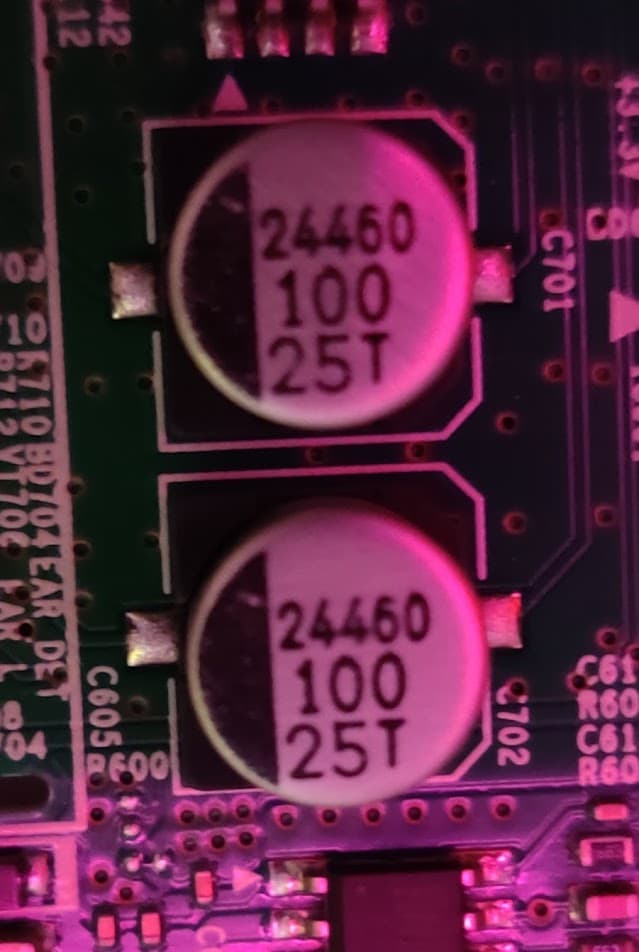

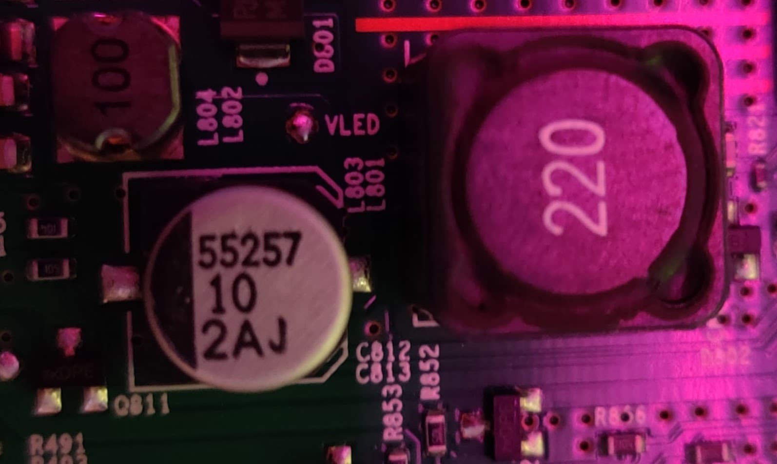

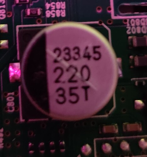

Could you please help me identify these?
After 2 hours of searching, for two of them i think that the top row is irrelevant lot numbers, middle is capacitance (220u and 100u), bottom row is voltage (25V and 35V) with T being some tolerance value.
The one that doesn’t fit is the one with 10 and 2AJ. I found some indication that 2A could stand for 100V, but 10u 100V seems out of place kinda? They are all on the same board from a samsung monitor.

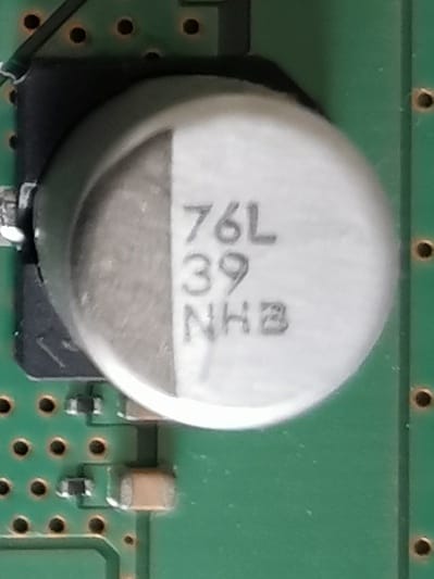

Hi does anybody know what voltage the voltage code N represents on this capacitor

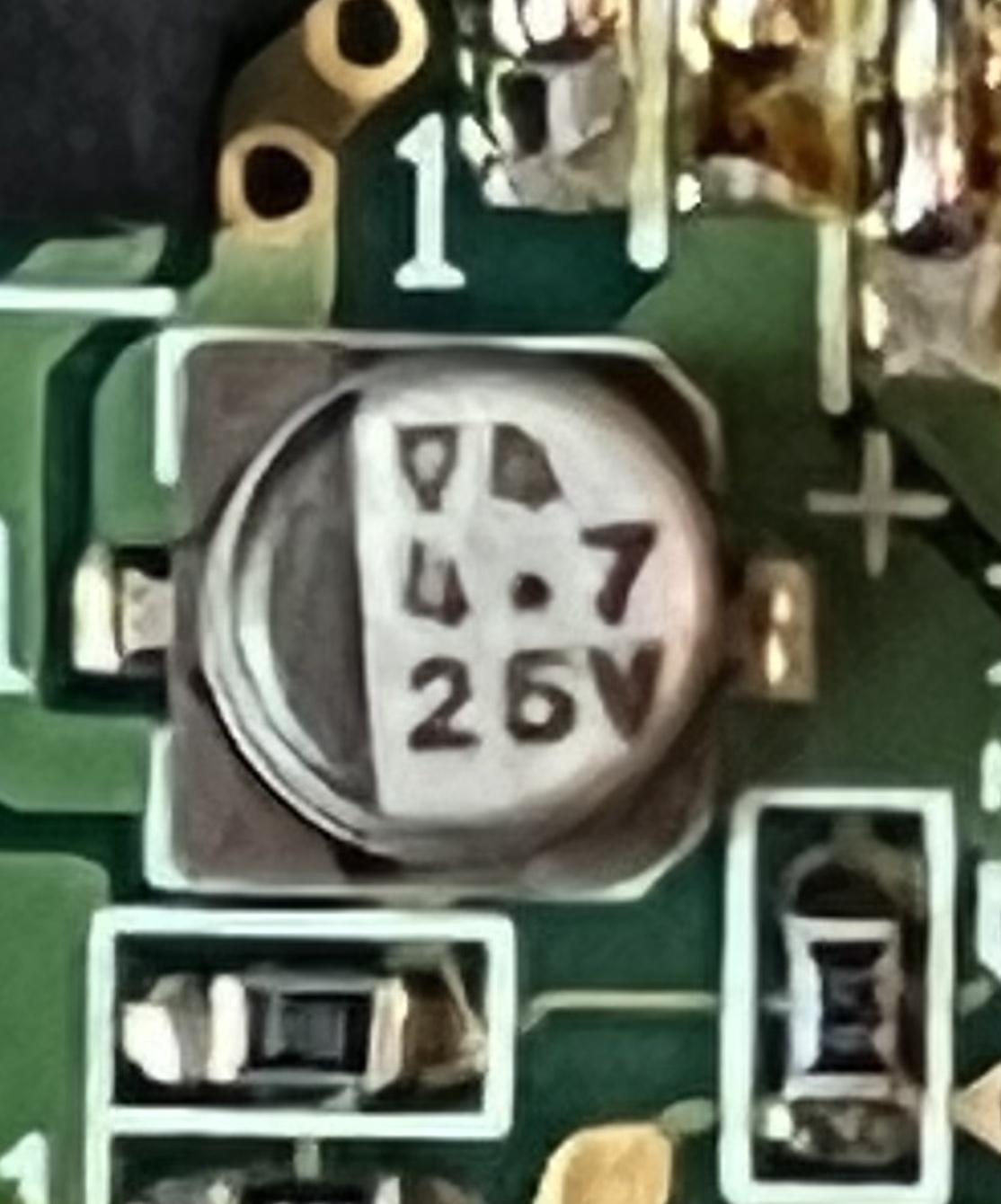

Hello - this is from a video game unit, and appears to be 4.7 uF and 25 Volt. Can you confirm? I am specifically looking for the most suitable part to replace this. It is 4mm diameter by 5mm tall. Thanks!
Welcome to the Technical Forum. Yes. I agree with the value. The closest part number I found is 493-17809-1-ND. I only found one piece in stock. The link is: https://www.digikey.com/short/tb90cdwm . Sorry. This was the only polarized one we had in stock.
Thanks for the quick reply! Fortunately I only needed 1, and just ordered it. Thanks again.
