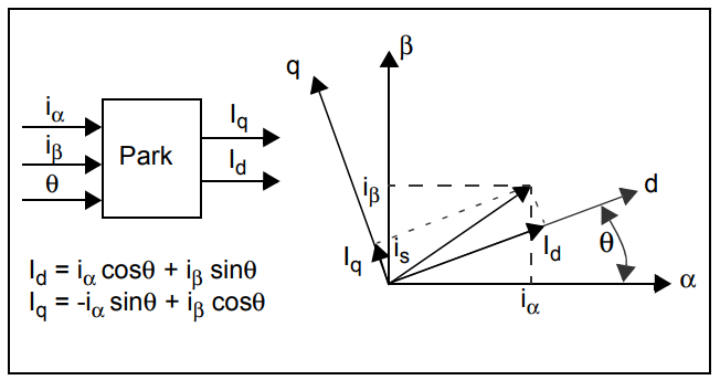

The figure below illustrates the principle of the Park Transformation through formulas + vector diagrams:
Park Transformation Principle Block Diagram
(Image source: Microchip)
The vector diagram on the right intuitively shows the projection process of the current vector:
- is: The space vector of the stator current (its amplitude equals the effective value of the current, and its direction rotates with time at a frequency equal to the electrical frequency).
- iα, iβ: The stationary projections of is on the α-axis and β-axis (they rotate with is and are always sinusoidal AC currents).
- Id, Iq: The projections of is on the synchronously rotating d-axis and q-axis:
- Since the dq-axis rotates synchronously with the rotor, if the motor operates in a steady state (constant speed), Id and Iq will become constant DC quantities (this is the core value of the Park Transformation!).

3. Mathematical Formula of the Park Transformation: From αβ to dq
The formulas on the left side of the diagram define the transformation relationship:
- Physical Meaning: It projects the currents iα and iβ (in the stationary αβ-axis) onto the synchronously rotating dq-axis, resulting in the d-axis current Id and q-axis current Iq.
- Formula Derivation Logic (Geometric Projection): Taking the d-axis as an example:
- iαcosθ: The projection of iα (α-axis current) onto the d-axis;
- iβsinθ: The projection of iβ (β-axis current) onto the d-axis (since the angle between the β-axis and α-axis is 90°, the angle between the β-axis and d-axis is (90°−θ), so the projection is iβcos(90°−θ) = iβsinθ). The derivation for the q-axis is similar. The negative sign comes from the direction of the q-axis: when θ=0, the q-axis is aligned with the β-axis. Substituting θ=0 into the formula for Iq to verify: Iq = −iα⋅0 + iβ⋅1 = iβ, which matches the expected result.
