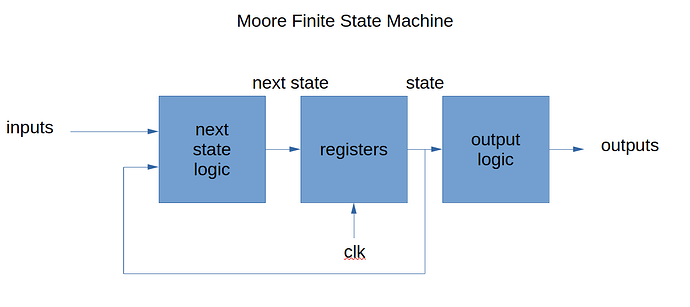

Contrary to the previous Moore FSM with three states (RED, BLUE, GREEN), where its outputs depend only from the internal FSM state encodings (only derived from the internal flip flops states, these have the state registers of the FSM, that is the memory of the FSM), the Mealy FSM uses the input next and the internal present state as a way of controlling its outputs r,g,b that are fed into the RGB LED in the board. Here is a block diagram of the Moore FSM to illustrate the difference outlined here,
In the previous diagram, the Moore FSM only derived its outputs from the internal registers that have the present state using a combinational output logic circuit. In contrast, the Mealy FSM uses the inputs (See redline below) plus the internal state encodings to determine its outputs as shown in the next block diagram,
